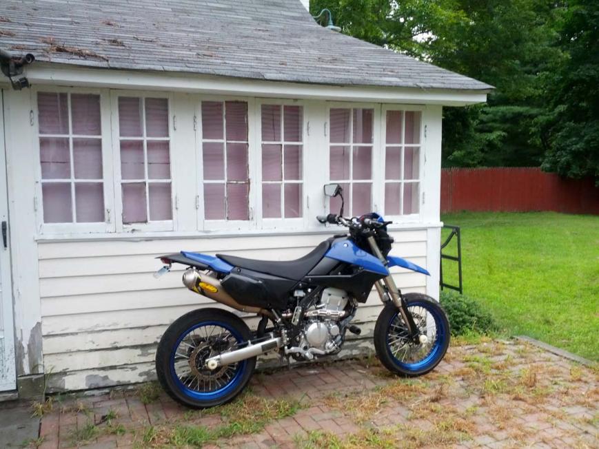

2010 sf. Q4, jetted, etc etc

Looking good!

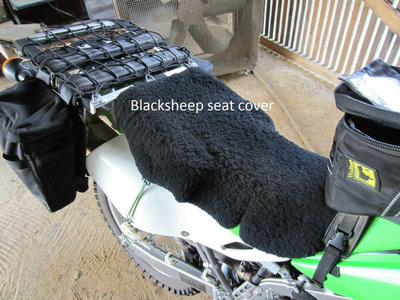

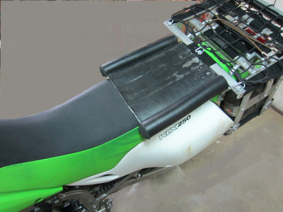

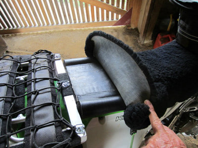

I built a butt saver for the longer trips. The original version had 2 pieces of 1 1/4" pvc pipe in a piece of vinyl, but I later changed that to a protaper crossbar pad which I split in half and added a 3/4" x 3/4" piece of wood to each side which makes it even better. The cover is a Blacksheep seat cover, but the Walmart version works almost as well. By sliding back when my butt gets tired, it changes the weight distribution to give you a rest without stopping..
A friend and I made an 1800 mile trip in 6 days with this and my butt never made me stop for a rest.

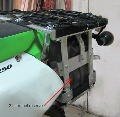

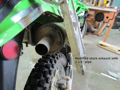

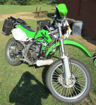

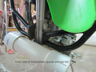

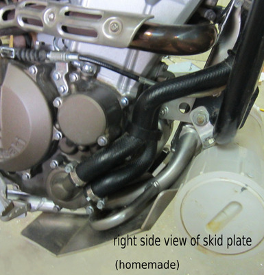

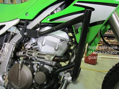

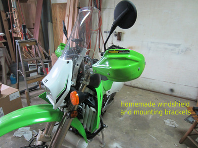

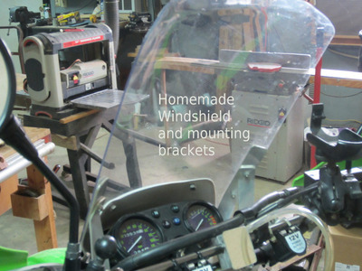

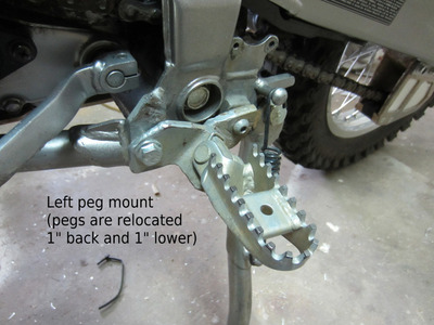

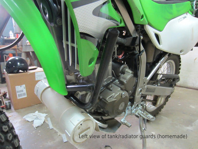

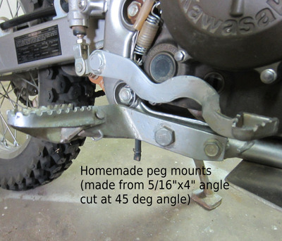

More photos of my '250. many mods, but very little money spent on them.
Except for tank bag, panniers, gas tank, hand guards and seat cover, every thing else I built in my shop.

John, that's some nice home-grown work there! What mods did you make to the stock muffler?

I just drilled out the back with a hole saw (using a piece of broom handle for center guide), removed the stock tail pipe and put larger hole in the last baffle. I then used a 1 1/4" flat washer to cover the hole and welded in a 1 1/4" piece of tubing.
It's still not too loud and seems to have a lot less back pressure.
