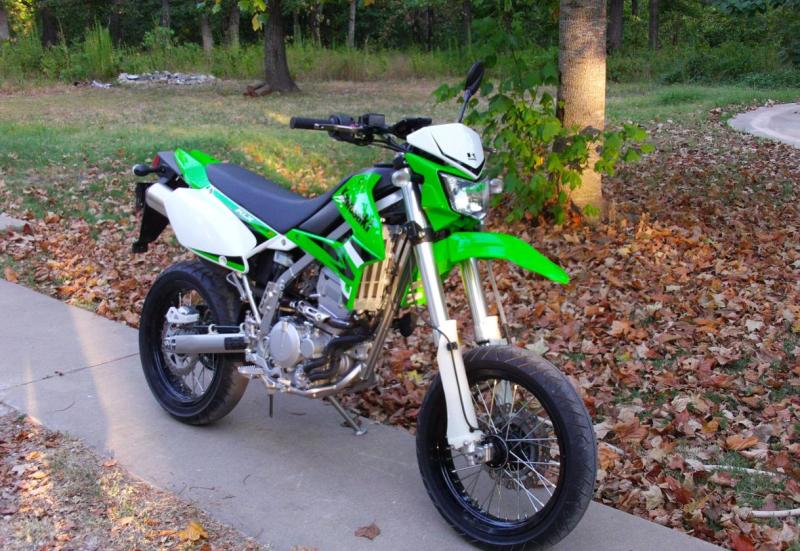

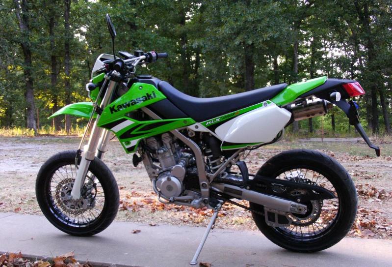

Still working on Supermoto conversion, buts she's getting there...

Are those the OEM rims (big $$$$$$)? I have a set ordered but the back one is on back order all summer. Not looking good for this season.

Hey Wildcard, my plan is to use the S rotors and 42 tooth sprocket. Is there any problems with this conversion (I was told that the hubs are the same just painted back so they should bolt right on)? As well any issues with the length of the side stand?

Yes OEM rims. got mine used for a little over $700 for the set, rear is a little scratched up, but only cosmetic.
You have to use the S rotor disc unless you buy the new brake mount thingiebobber for the SF as the disc is a little bigger.
No issues at all except the speedo will read WAY off unless you get something to correct the reading like a speedo healer or 12'o clock labs piggyback fixer.
Side stand still works, but i'm going to find an SF one at some point as the bike don't lean over quite as much as i would like it too anymore.

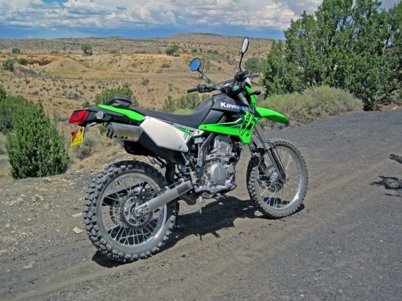

I was finally able to ride my new klx on some dirt! I'm really impressed with this bike so far!
