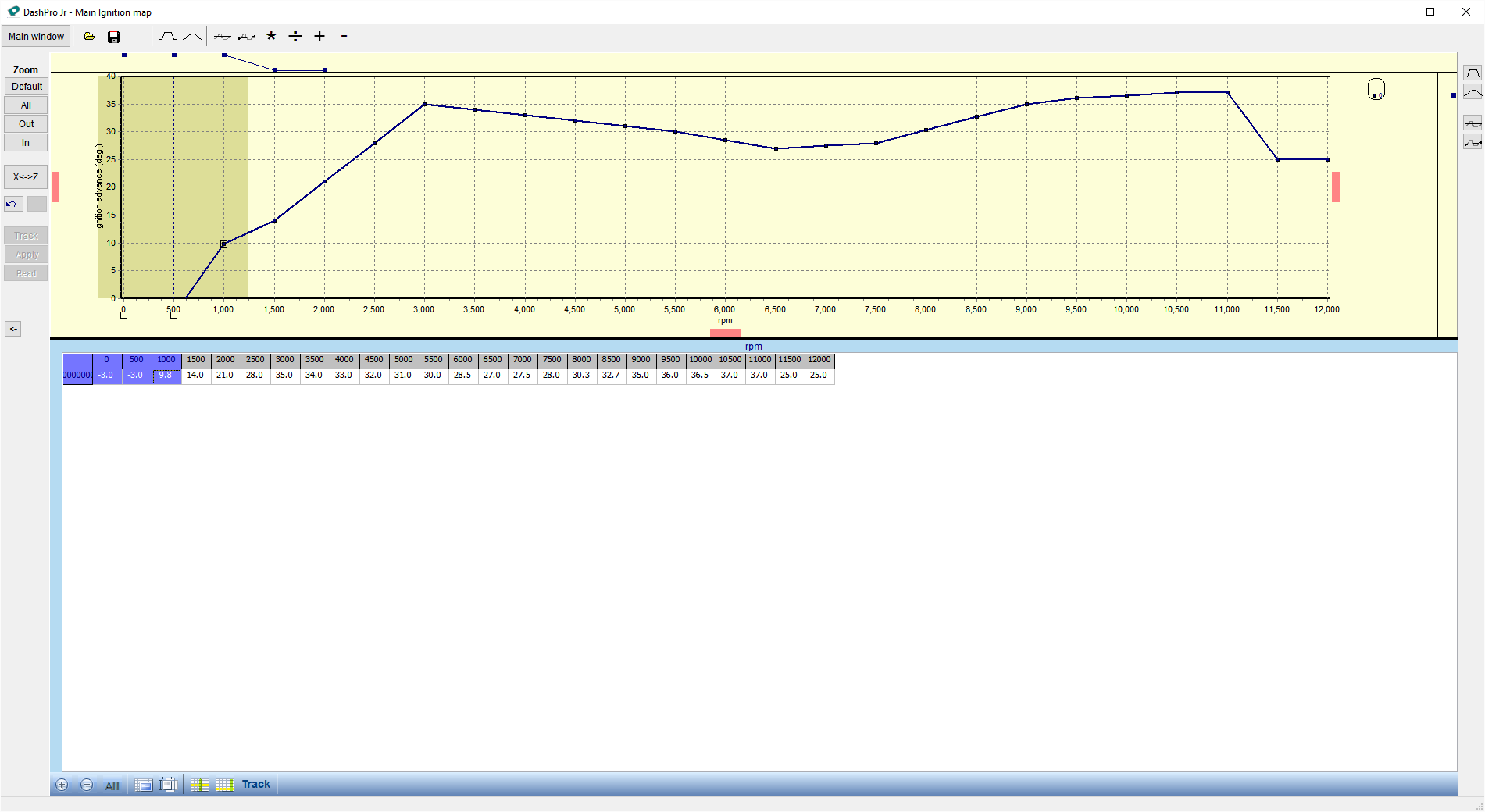

Re-tested all the curves. I waited until just before nightfall when the wind was calm..
Results are great with a few exceptions. Notice the big variance on the 26°. 27°, and 28° runs. These were the last runs of the night. I will spend quit some time contemplating what could have caused this. Off hand, perhaps she's getting low on fuel and gulping a little more water on these runs? I can take care of that easily enough.. Opinions welcome..
WOT 4k-10.2k
5k-8K measurements
Adv_Run1_Run2
23° 10.80 10.77
24° 10.74 10.71
25° 10.71 10.71
26° 10.74 10.62
27° 10.53 10.83
28° 10.59 10.80
29° 10.74 10.71
30° 10.68 10.62
I broke down all 16 runs into 1k rpm increments and measured. This has revealed the values that seem to give the best performance 5-6k, 6-7k, 7-8k, and 8k-9k - I already know a (so far) best value for 9k (35°)..
I know there is much more testing to be done, just in this 5-8k area, to further tease out the best values. But I'm wanting to see the results of the values of the "breakdown" all put into one curve.. So I created it and will run it ASAP against the stock 25°..
Here are the values from the breakdown:
5-6k 30°
6-7K 27°
7-8K 28°
8-9K 30°
Here is the curve, clik on it for full size:

I should be able to test the "Breakdown Curve" later today..
I did test power levels and ramping from a 2K snap-to-WOT. This was meant to verify/measure the effects of the "large front end" on the above curve, over the standard 25 curve. Without boring anyone, it's a turf covered hill climb with a long level entry area. I enter the upturn threshold with the bike steady @ 2k RPM, in first gear. As the rear wheel passes over the threshold, I snap and hold WOT. The instant of wheelspin is shown in the turf and is quite visible and measureable. I did not have to measure though, it was too obvious. With 25 degrees the bike starts wheelspin at the 3/4 mark up the hill, with the "breakdown curve" wheelspin starts just below the 1/2 mark.. It is a very significant increase in both power levels and power ramp-up.

I like the way this curve is looking. I think you can do a lot more testing but probably won't change this curve very much. Maybe 1 degree here or there. I have a feeling this will be the basic shape of your final curve. I'm already planning my ignition swap!!

Yes, Hoot, I agree that this overall "shape" is probably going to be the best.. But I am not "married" to it or any other conceptual "ignition curve form" . Everything is going to have to test out and prove itself..
There is much more tweaking to be done - values need to be determined down to the 1/10th of a degree. The math shows that optimized timing requires such precision. As I get closer to a best value for a given RPM, the power levels keep going up.
The "ramps" on the "big front end" of the curve will likely be more trial and error. However I will certainly be able to measure this RPM area as well..
You must get the programming cable, and you really should get the handlebar switch so that you can have two maps at your fingertips. I think having a "easy going" map and a "***** out" map, with the handlebar switch, is best..
