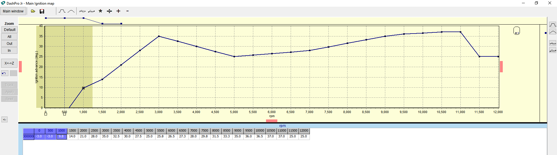

Taking a cue from RageHard..'s map, I added a "big front end" to my latest test map - I tempered it a bit due to my bikes' different mod combo.. I tested power, throttle response and power ramp-up from 2K while climbing a 75 yard run up a hill offroad. Sure enough, more power, throttle response, and power ramp-up.. Here it is. Clik on it to read the values.

What does the bottom most row in the attachment above represent? Can't quite make out the text or numbers.

The row I'm curious about is in the red box..

Ah, this is a screen shot of the ignition advance curve I tested today.. The program is called DashPro Jr.. Those are cells with advance values in them..

Ah, for a moment I thought we were looking at HP numbers!

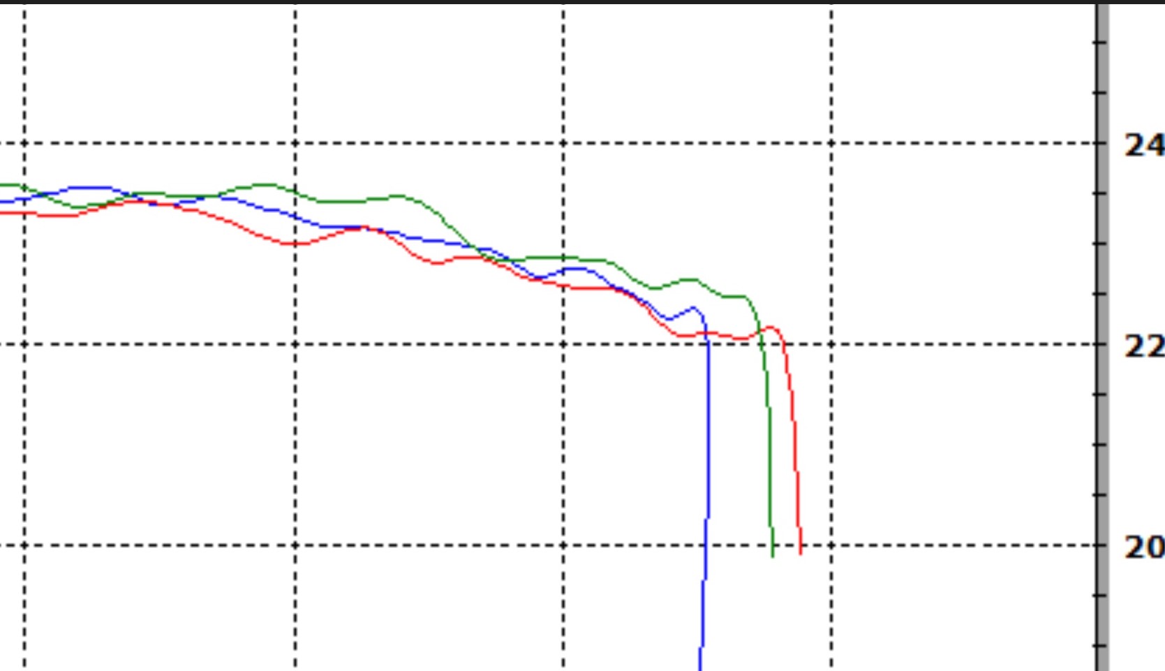

Here is the 35° jump in power. The verticals are RPM - 8500 on left, then 9k, 9.5k, and 10k..Hp is the numbers on the right. All 3 curves are basic "flat line" curves. So all of them are static values after 5K.
Blue - 25°
Green - 35°
Red - 40°
This is an example of what happens when ignition timing becomes more optimal , when it over-advances to "stalemate", and finally, when it over-advances to power loss.
Also, while 35° did this, there could be more with a different value in this RPM area.
