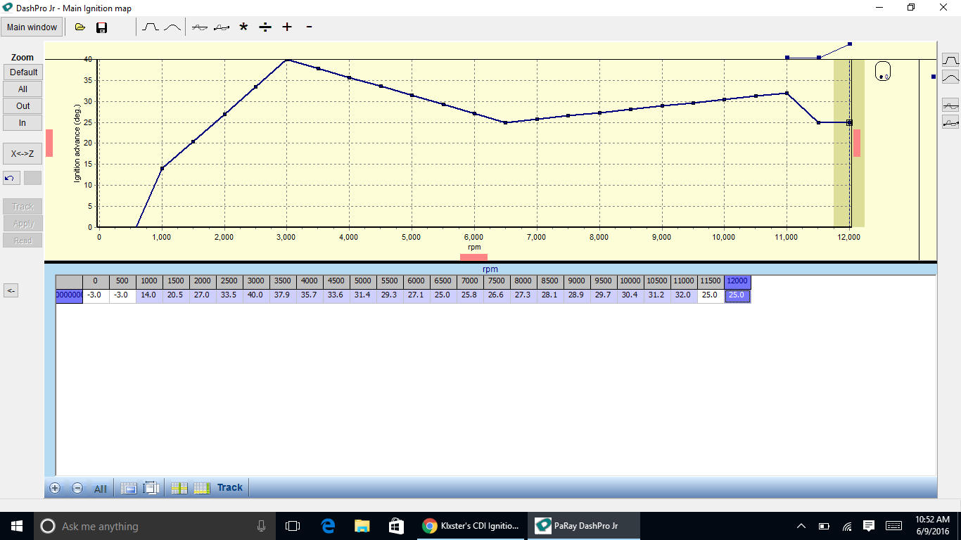

RageHard.. Running thought experiments as my knowledge on the subject increases, I've come up with a map suggestion for you. Basic premise is that as your particular setup (slide, spring, etc) begins to uncover the K152, the curve must not over-advance the richer AFR. Key points are 25° at 6500 rpm with a slow ramp-up to just over 30 at 10K with the target value of 32@11k.. I assume you feel Max TRQ start to come on around 6500 ?

Very interesting, yes still feels like peak trq is around there somewhere. I have thought the straight 40deg may be losing a bit in the mid rpm range based on a long 6th gear climb I do all the time. Hard to say when the top end feels stronger though. It's pouring with rain today but I'll try and upload this map and go for a ride tomorrow.

Ok, I didn't include the file - just a sceen shot.. From what you're saying, I might need to tweak it some before uploading it..
I expect PEAK TRQ on your bike to be 7K-7.5k.
I expect you to feel the beginning of the big TRQ ramp-up at 6k-6.5k
.. Am I close?

OK so the rain eased enough to go for a quick ride yesterday evening. Here is the map I created based on your suggestions.
I did keep the 5 deg initial advance as I feel it makes the bike easier to start especially when hot. I was also trying to pay a little more attention to the tach on the 6th gear hill. Basically hitting the bottom of the hill at 6500rpm and going WOT to the top so it seems like a good gauge.
There does seem to be a marked improvement with the current map over the straight 40 deg advance from 3000. Was definitely pulling stronger in the mid range yet the "extra" power I was feeling at 3000 and up towards redline is still there. Still early days but it seems like you on the right track here.

Ok! For further tweaking, move the 25° point left or right.
I tried to put it at the point where your CVK setup goes below 13:1 AFR which, I think, also happens to be the point where your TRQ starts to really rise.
( I am basing all this on the assumption that the stock lift hole and slide spring are delaying or "easing into" the "full effect" of your K152 somewhat - even with the N1TC at 2N..)
For instance: You could attempt to place the 25° point directly "over" max TRQ (probably somewhere closer to 7.5K) ,, If you do, check for "flatness" or "dullness"(over advancement) in the power ramping between 40°@3k and the RPM value you put the 25° on..
Or you could move the 25° point to the left, perhaps getting it closer than I did to the very beginning, OR just ahead of, the "big pull on your arms" TRQ ramp..
At any rate - As time goes on, I'll know more.. But as of now, it seems advance should be increased VERY gently or not at all during the "80% of max TRQ" area of the power curve - perhaps(I'm guessing here) 5.5k to 8.5k on your bike.
