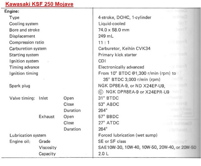

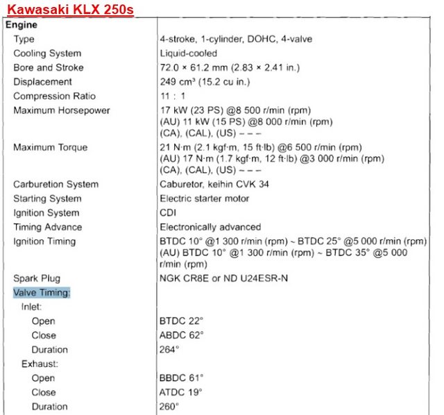

So I checked my Mojave service manual and saw this interesting information:
Mojave Valve Timing -
Inlet Open: 31 deg BTDC
Inlet Close: 53 deg ABDC
Duration: 264 deg
Exhaust Open: 57 deg BBDC
Exhaust Close: 27 deg ATDC
Duration: 264
KLX 250s Valve Timing -
Inlet Open: 22 deg BTDC
Inlet Close: 62 deg ABDC
Duration: 264 deg
Exhaust Open: 61 deg BBDC
Exhaust Close: 19 deg ATDC
Duration: 260
Looks like the Mojave inlet opens 9 degrees before the klx, closes 10 degrees before. The exhaust opens 4 degrees after the klx, closes 7 degrees after. So the Mojave inlets timing is advanced and the exhaust is retarded in comparison to the KLX. Sound familiar?
Below are spec scans for each machine for reference.

Same 250? Shows a different bore and stroke.

So, MCM is similar to stock KSF.. Don't know why this is important but it is interesting..

Any of you wonder if that 74mm piston would fit in the KLX? That is how I ended up with the 678cc KLX650 - Vulcan piston was 2mm bigger. Wonder how much liner metal is in there or is the 250 a plated bore.
