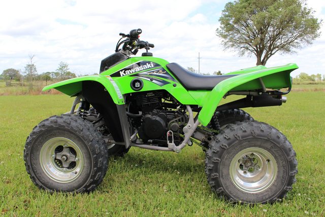

Hey all, Im contemplating doing the mod on my 2009 250s, but it seems Marcelinos dyno graphs are not visible-- does anyone know where I can see them?
Im getting ready to slap on a DG O-Series , Kouba Fuel Screw, and richen the jetting.
Already re-jetted with airbox mods and drilled baffle of stock exhaust, currently running a DJ 126, stock needle w/ 1 shim, and 40 pilot jet. I started with a 135 Keihin main and the KLX 300 needle at 3 or 4 from the top, but it was WAY too rich ( I mean it would run, but gurgling and sputtering and stuff).
I dropped to a DJ 130 MJ, lowered the needle a notch, and it ran a lot better, but still felt very flat on top, had trouble getting it over 75mph on the speedo.
Current setup, bike runs very good, starts very easy and pulls strong to about 80, will top out about 85 if given enough runway and tucking in.
I have two KSF/KFX 250 Mojave quads with almost identical displacement, one with a WB E-Series and one with a DG pipe, running UNI carb clamp on filters, and they pull like animals with 135 and 138 Keihen mains. They "feel" like they have much more torque and power than my KLX, Im hoping the DG pipe will allow me to use at least a DJ 134 or Keihin 135 main. If I can get anywhere near the low and midrange my Mojaves have Ill be a happy camper. Im very curious as to how the stock Mojave timing compares to stock KLX and MCM timings. I have a Mojave service manual, Ill check it out and post my findings. I suspect its quite a bit different from stock KLX 250, just from how strong they feel across the band.
The MCM sounds intriguing, but I cant find a single dyno graph anywhere on the net. Doesnt feel right doing something like this completely blind.
