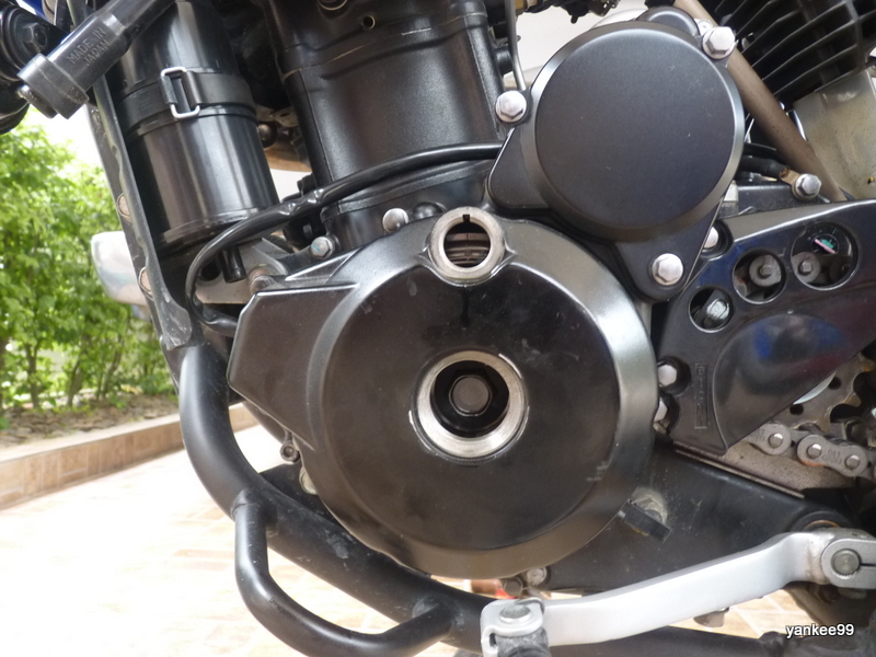

Just some pics a note...I originally lined the crank up 180 degrees off. My eyes are not great and i looked at the line and the cams seemed correct....This could be disaster if you remove the cams then put them back as per the op foto..
This is critical the T is horizontal ... I thought it was vertical and the top stamp was not good....reminder to myself dont think
The cams installed
The acr well i am not sure what the deal is....I dont have a before pic another mistake....I removed it and went to the shop pressed and rotate ccw 1/4"... This was too much as the round piece was 50% below the head...I took it back and had them rotate it 50% cw towards the original position.... it is still about 10% below where the op recommends but it is starting fine....I believe the original position would have been fine....fyi I tried to remove it with a bolt as mentioned earlier in the thread (page 20) with no success. Even if i got it apart reassembling it would have been a issue....
