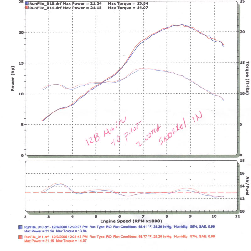

here's my old 06 on the wheel:
this was not my best run, but was the best fueling. Made some more power with a K & N lid off and 132 main. But I don't like to run K and N in the dirt, and don't like the noise of the lid off. So compromise. This "best fueling" run also went too rich over 6000" mainly the fault of the 300 needle that was in it.
