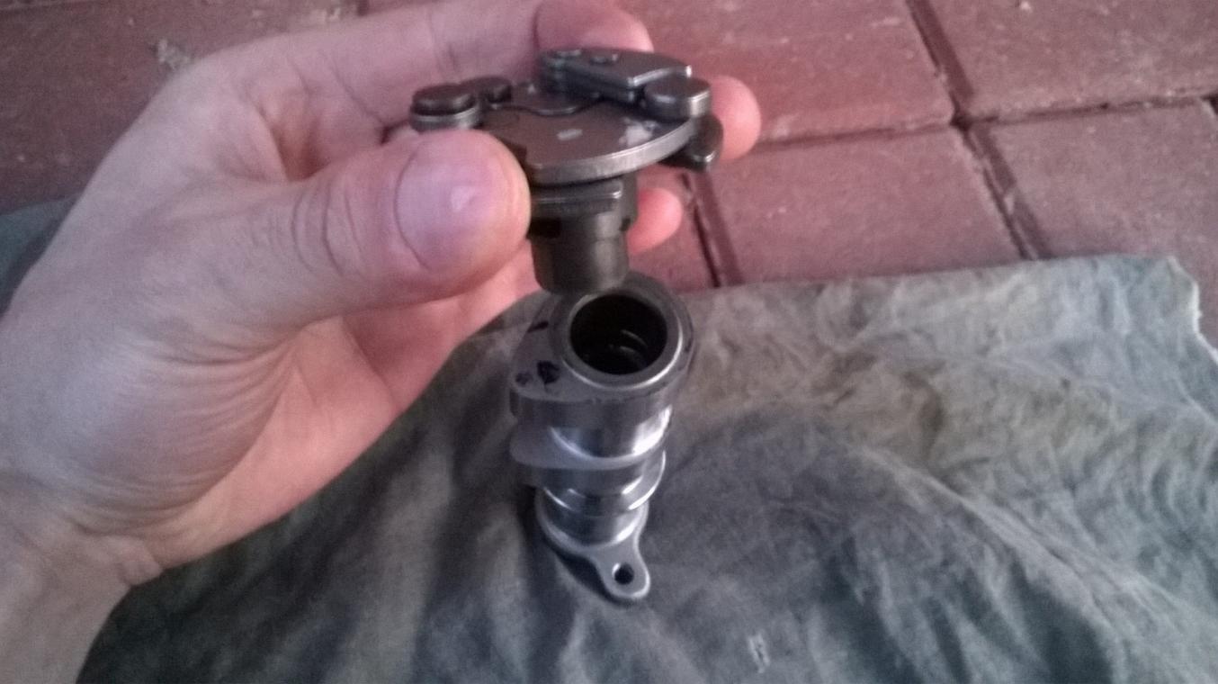

I don't advocate sticking a wire onto a rotating mechanism.. Simply removing the spring completely deactivates the KACR.. the entire mechanism presses out - off the camshaft.. I drifted mine off with a large punch and a small sledge hammer - obviously while the camshaft was properly supported.. I certainly would remove that thing permanently if I had to do this over again.

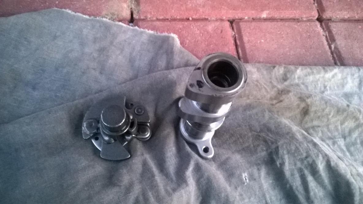

Right, the final decision was made to remove KACR by using a press. This is how it looks splitted.
I hope these photos will help others on how to remove KACR.
I performed Marcelino cams mode. My cams are rotated and the exhaust cam is lighter now.
I removed the lid off.
I noticed the engine starts faster now. No mater if it is cold or warm.
Can I do front wheelie now without clutch? No. I haven't notice big difference using new configuration.
if I go on full throttle I notice a slow response (that was before mod too). No matter if my CO2 is connected or disconnected with bypass. I have KLX 250 with fuel injection.
For some reason I still have that throttle delay.
Next, will order EJK controller and will add head pipe and muffler from KX250F.
And probably first I would need to dismantle fuel injection. Just to verify if previous owner haven't made any interesting mods here
My older 1998 Honda XR 250 with carb runs better, throttle response is much much quicker.
Based on sound metallurgical and mechanical engineering properties I do recommend putting a piece of mild steel round wire in the compression release mechanism to lock it in a disengaged position, rather than allow the shoes to flop about unrestrained. It is a sound mechanical practice in this case. Everything is locked in position so there is no movement, but it is still totally reversible. One just needs to look and consider the facts here and make the appropriate bends in the wire to lock it in place. You will destroy something else long before that piece of wire bent one time at each bend will fail.
I put it out there that I used coat hanger, because I knew it would get a rise. Coat hanger is simply round low carbon steel, much like what was likely used to make some parts inside the engine. It just happened to be virtually the perfect cross section OD too. It will bend without fracturing and will stay in place better than the spring itself. I had the spring on a similar CR in my KLX650 come off twice. The only way you will get that wire out of my CR is if you use cutters or bend the snot out of it. There is no way it can come out due to any rotation of the cam. You see, I'm no rookie at this.
But if I have to pull the cams out in the future I will have the whole mess pressed out after finding it wasn't necessary to have it. It is just an appendage remaining from the kick start engine KLX300 and first 250 before e-start. Neither the Honda nor the Yamaha 250s use compression releases on their 250s. It is just an unnecessary complication.
