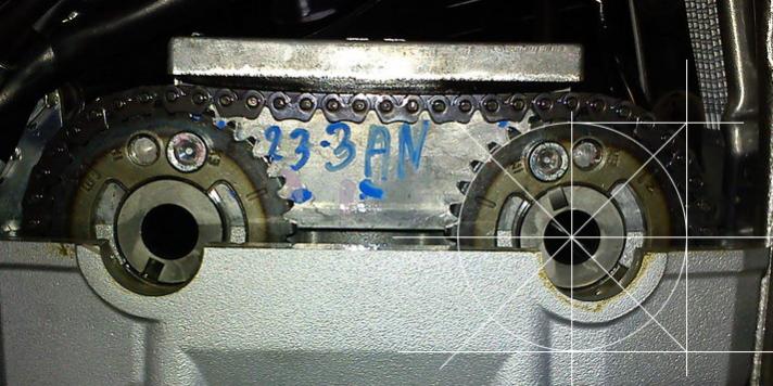

In your original post you had a sprocket tooth count of 34 for your KLX250EFI.
While I had mine out I did a count and found it has 32 teeth. That's also what the diagram in the service manual shows. I double and triple counted just to be sure. According to the Ron Ayers site, the p/n is 92046 (from memory).
There will be a (very) small difference in degrees between the two. 720/34/2 = 10.58 and 720/32/2 = 11.25.
I'm currently running the mod on my 250 without any difficulties and plan to keep it.
Could this difference perhaps be just enough to affect the 351, perhaps?
I was going to ask this yesterday but forgot.

It does not change anything .
I also saw 32T over bikebandit.com, and I count 32 on the picture Marcelino posted.
Still doing the mod, thou.

I was thinking while reading this that we should put our heads together and come up with a way of marking the cam sprockets that this mod has been done. I just envsion someone buying a used KLX 250 without knowing it had this mod, installing a BB351 and timeing the cams by the book thereby puting the cams out by 2 teeth or 42degrees(assuming I understand the mod correctly) This could also occur if one of us does the mod but then later takes it to a shop for something.
I know one should turn the bike over by hand after reinstalling cams but I am just saying there is some serious potential for inadvertant harm. & Yes if you know about the mod you could remember to look at which holes the bolts are in, but for the uninformed...........
I have a killer engraver and will be engraving something on the sprockets.
