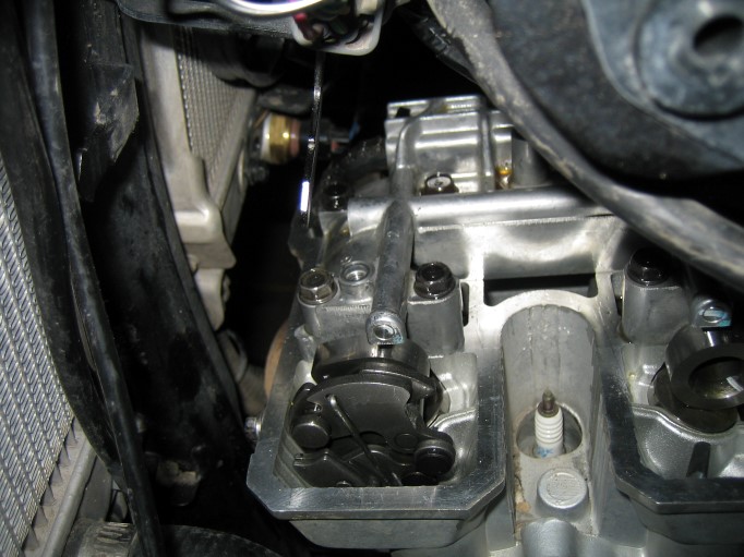

Did I do this right?
So the garage finally warmed up enough for me to work on the MCM. I removed the cams one by one, rotated the chain sprokets and threadlocked them back on. I was surprised that even with the cam chain tensioner removed, there really wasn't any slack in the chain, just enough to get the cam off. I guess that's due to the sub-tensioner, which I didn't remove or loosen?
Anyway, could someone who has done the mod look at theses pics and let me know if it looks ok? Basically, the intake lobes are a little higher than before and the exhaust lobes are pretty much in the same position, with the crank at TDC.
How will this affect the next time I check the valves? Should I just set it close to TDC and then place the intake close to where it was originally or does it not matter that much?
All valves were in spec, close to the tight specification (2000 km on the odometer). While I had everything apart, I also installed a Krieger cam chain tensioner. Hopefully that takes care of the 5500 rpm rattle.

Looks good. As long as the KACR is wired with the shoes all the way out, you're good to go.

Turn it by hand, then by starter, then install plug and start to idle, then ride slow.. If it checks out each time , congratulations !
Now yank the lid off the airbox, richen the pilot circuit (Fuel screw) and the midrange circuit ( needle clip position ), put in a properly sized main jet for your altitude, and get some speeding tickets .

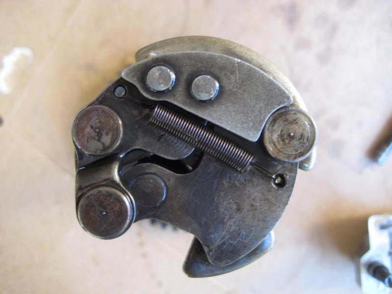

I have disabled KACR for now using a peace of steel wire.
Including image of KACR without wire. Just curious what exactly the part should be pressed out in order to reposition KACR. Can somebody draw it in the image?
Thanks
