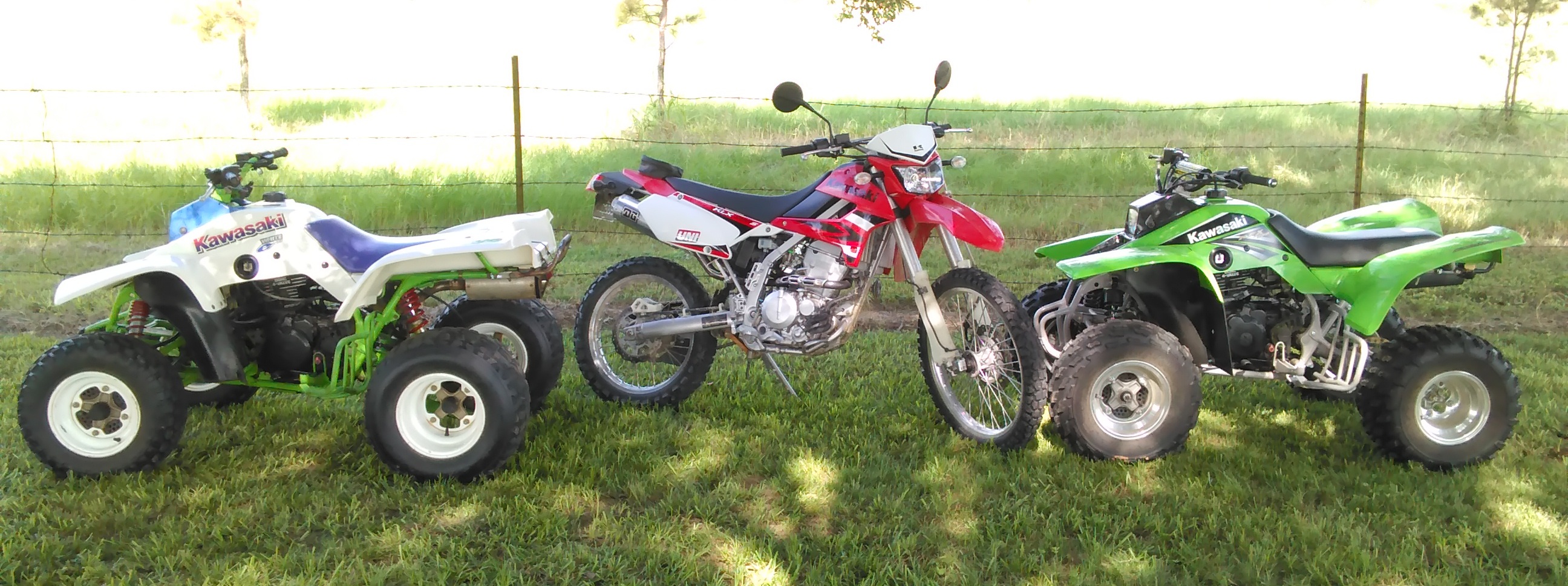

My little rice burning toys. All running great, the 300 carb is doing fine on the KLX, been having a blast riding it lately. Still need to fit the Kouba screw and #40 pilot, but other than that, no complaints!

Josh,
Nice collection of ricers, hahaha!
Just curious about your 300 carb comment - KLX300 carb? Isn't it also a CV34?

Originally Posted by Josh128
KSF 250 Mojave/ KLX 250s/ KFX 250 Mojave
The one in the middle is the wrong color!

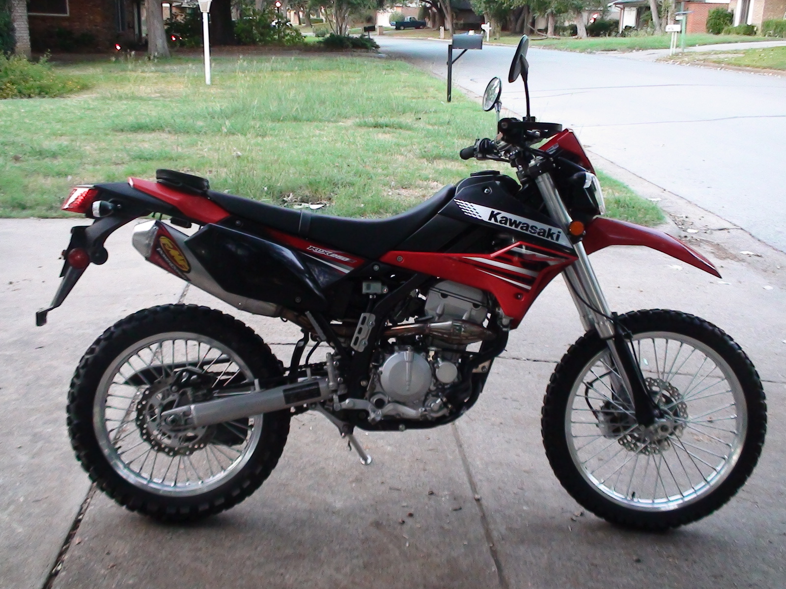

Hey! Reds are faster.
Attached Thumbnails Kawasaki Overload... Happy 4th of July Everyone!!-klx-pic.jpg

Originally Posted by timc63
Josh,
Happy Fourth back at ya! Great country, for now...
TC
It is a CV34-- ALMOST identical to stock, but has a few differences as you can see in the pictures I posted in the 4K stutter thread.
Im 99% sure, for whatever reason, the K148 main is a bit too rich-- at about 80mph indicated, the bike will not rev any higher, whether upright, or tucking-- I was able to acheive about 87-88 with my previous K145 and 138 setups. I dont know why theres the discrepancy vs KLXsters AFR readings, but when I pull the carb to install the 40 pilot and Kouba, I am going to go to a #145 main and see if I can get it to rev freely on top again.
