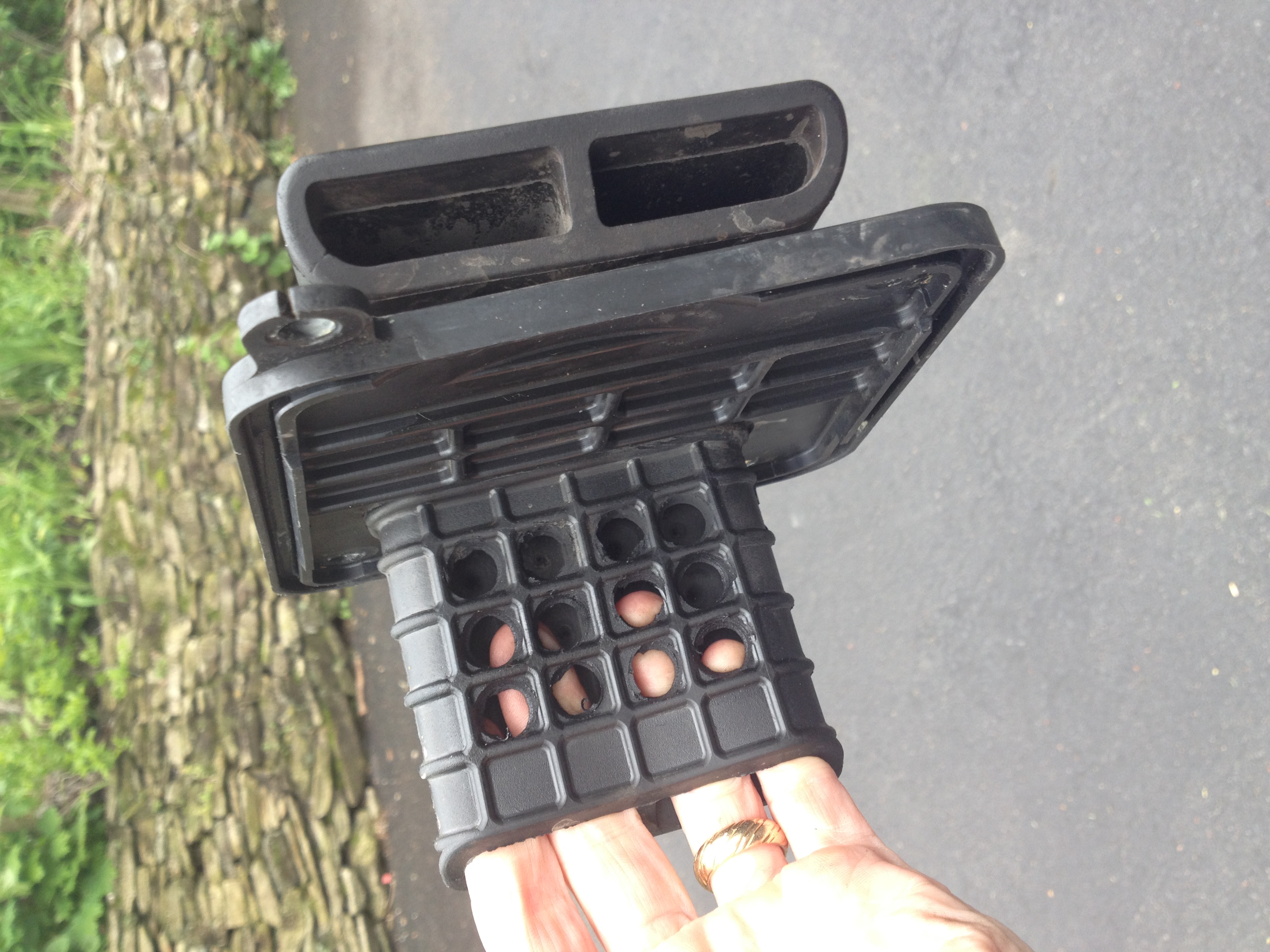

BTW, I pulled my lid off today for the first time (had the bike for a week and it finally stopped raining) and found my snorkle like this...was this modified, or are the sloppy hole punch-outs stock?

While your waiting for Pika to respond, I'll tell you that your snorkel has been butchered by a previous owner - so you may want to consider and start looking for what all else that misguided soul did to your bike.. If he was able to remove the carb, it requires more skills than hole punching a snorkel, he may have made alterations in it too..
