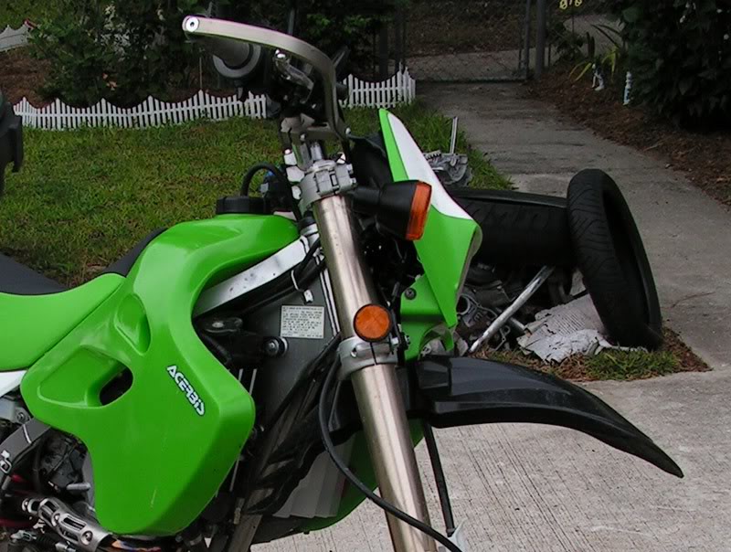

Hey Marty, do you have some pics of the tank mounted?

Yeah some pics are always good.

Mike,
I certainly do!
Here's a link to the thread I posted most of them in.
Here's a couple of new ones.
I routed the overflow line to an already existing frame mounted retainer. Seems to work well.
Accessibility to the radiator is very good. The radiator is also well protected.

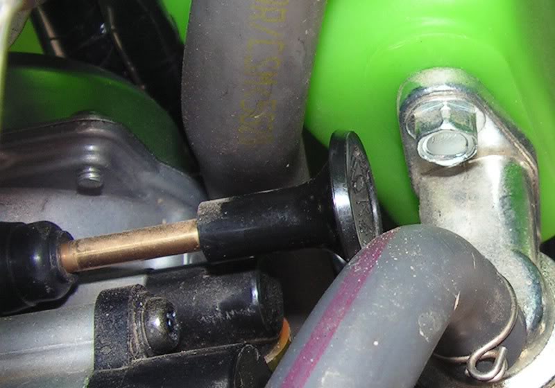

The only problem I had with the entire installation was with interference of the choke. While I don't normally use the choke since I've re-jetted the carb and opened up the pilot screw, I still want to have access to it. I have not had a chance to play with it yet, but it looks like I will be able to make some room by decreasing the size of the already small **** on the choke. Another solution might be to shorten the length the know protrudes by about 1/2 inch.

Aside from that one issue, all you need to do is follow the directions that Acerbis sends with the tank.
There is nothing else that you need to order, simply place your order with MotoSport.com and as soon as they get it shipped to them, they will ship it to you and THEN charge your card! Not the other way around like most of the other internet stores!

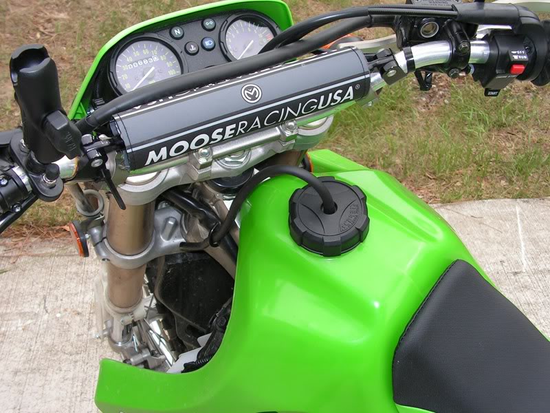

Stupid question but whats mounted on your handle bar?

I'm guessing GPS mount

It's my Ram mount.
I use it for GPS / Camcorder / Camera with remote trigger or whatever else I want to mount!
Works great!

+1 on the RAM mount. I have two - one for my GPS and one for a camera - solid when you cinche them down and easy to adjust and remove also. Good design.
