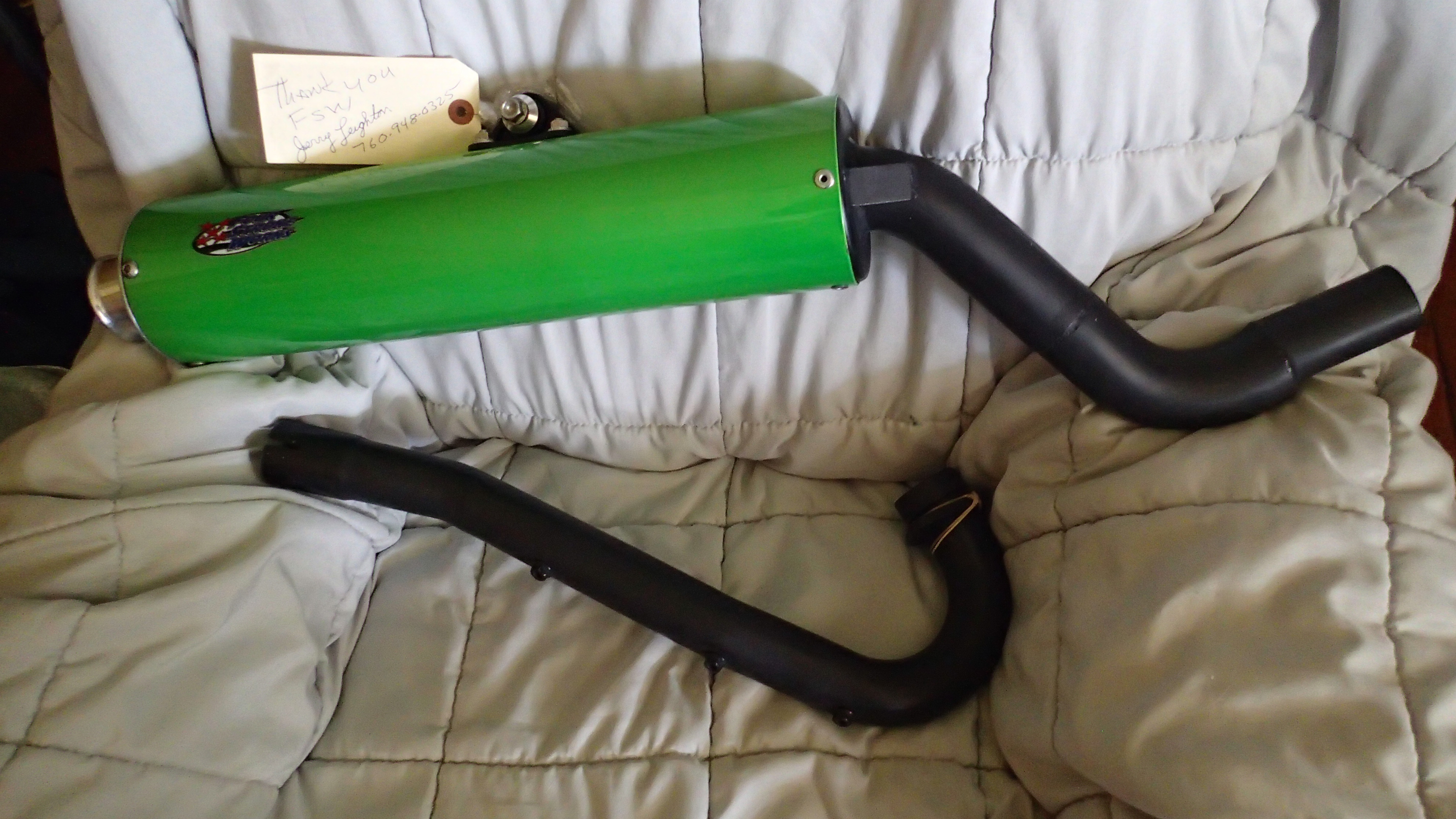

Hi all!
Here is my new pipe from Four Stroke Works. I ordered a DynoJet kit and have the KDX 200/220 snorkel. Siri tells me my living room is 2,881 ft. above sea level. You know, just in case I want to do some laps around my living room... I'd sure like some jetting suggestions. I'll drop as low as 1,000 ft. and no higher than 4,000.
Ordered a fat bar and grips, too. I've always had good luck using spray paint to put the grips on. Any thoughts about that method vs. glue. Any thoughts on using baling wire. My Gas Gas EC200 I bought used has baling wire on the grips. I must say I don't ever remember having a problem with grips spinning.

I am interested to know why you chose that pipe over offerings from FMF which seems to be the going thing around here. That's the first one of those I have ever seen. The color matched green muffler is interesting too.
How loud is it?

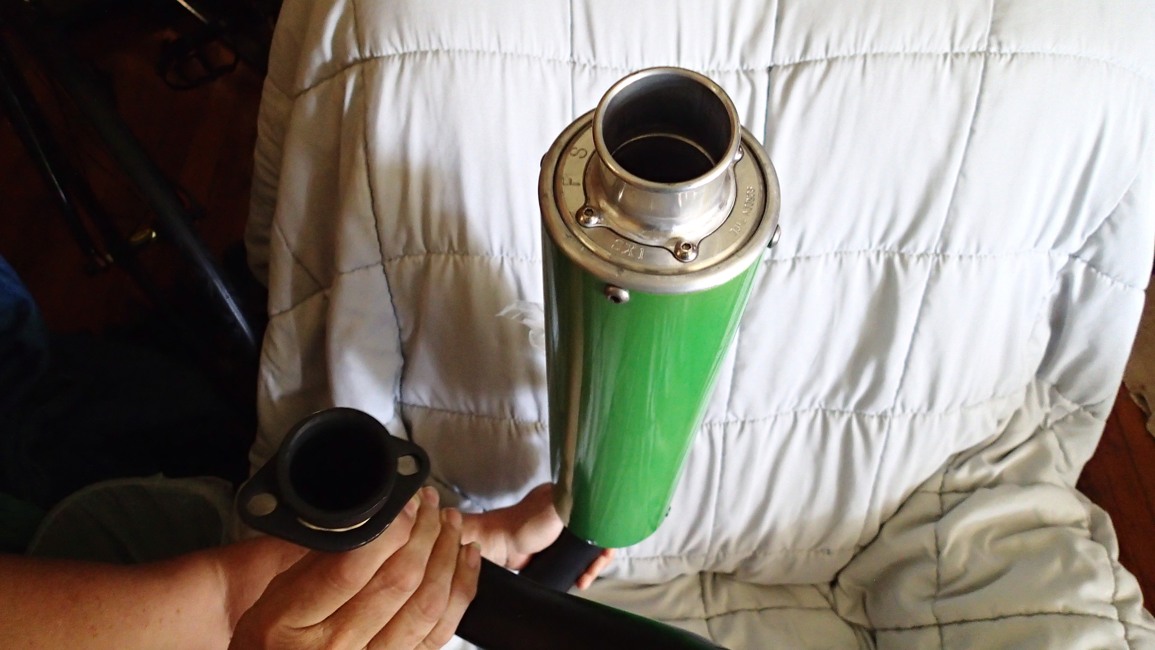

Well, I'm not real smart, but hey what ya gonna do. I'll put it on at end of month, still waiting on dynojet kit. I don't know if I'm totally sold on the FMF "cold weld" process. I know it's most popular. I intended to get a Muzzy but I think they may have gone belly up. I know Rob Muzzy retired. Someone mentioned Stroker which was started by Larry Roeseller, a pretty famous off road racer back in the day, and they built his bikes. Their chief engineer Jerry owns and runs it now. He is nice old guy and it's kinda a Mom and Pop shop now, I think. They do sell a quiet insert for it. I think all it does is reduce the diameter out the back... It's regular old painted mild steel and an aluminum can.

The latest Dyno tests indicate very large power gains from off idle to 8k with the stock header+slipon+lidless carb setup..(https://www.kawasakiforums.com/forum...klx250s-44229/) I assume the FSW header is larger Dia. piping than stock. If so, the FSW header will move the power curve higher in the RPM range with a "softening" of the power curve @ low - mid ranges. But it will allow strong TRQ to be made, starting somewhere in the midrange, all the way near redline.. I hope this is to your liking..?
One thing is for sure, MCM + stock header+ slipon+your choice of proper refueling to match your choice of airbox config, makes a TRQ monkey outta the KLX - off idle to 9k is supa-powah..
But don't worry, if yall fuel the bike well with that FSW on, you'll have more power, you'll be happy, and that's all that counts, right? Bro may not want to make the trip just to try out a new config on your bike every now and then...
