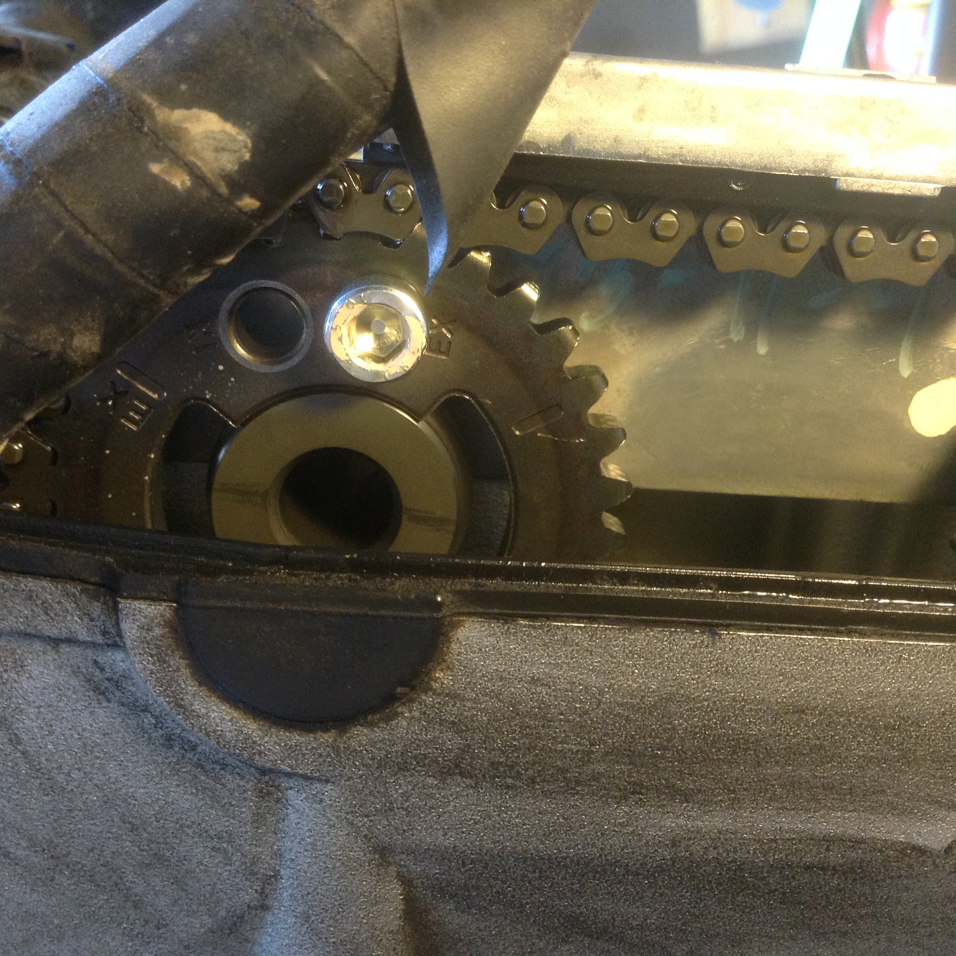

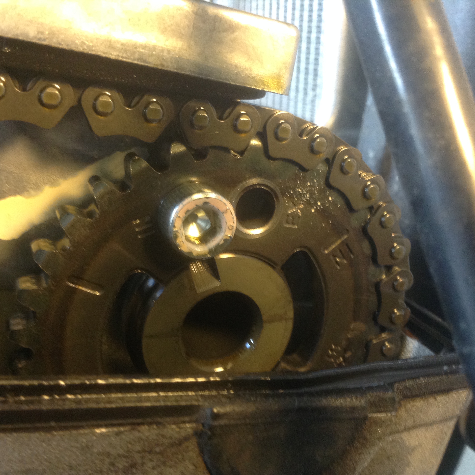

Intake cam will be in exhaust holes on cam sprocket and exhaust will be in intake holes.

Yep and off 2T as in pictures. Otherwise I don't think there is any other absolute proof to be positive the change has been made.

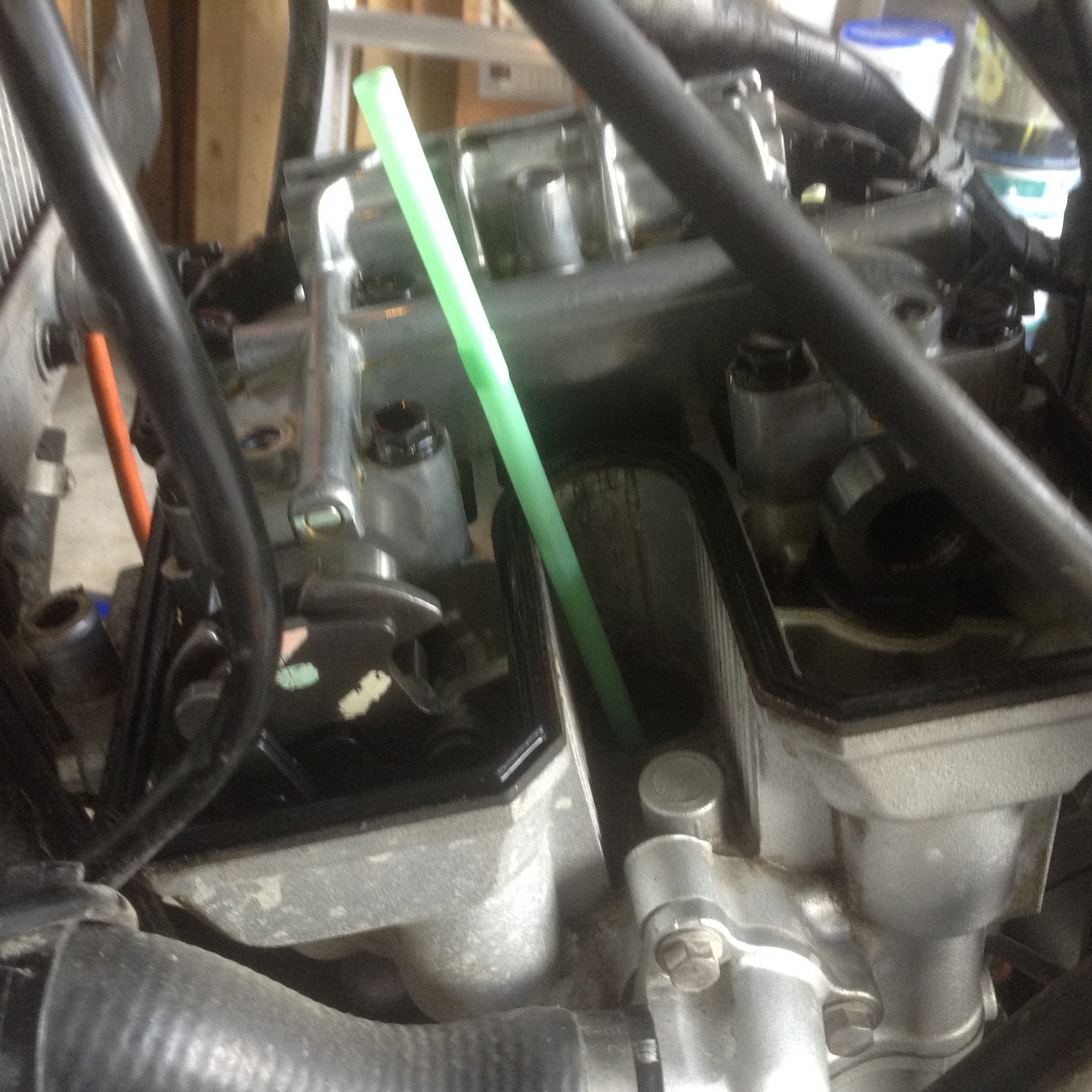

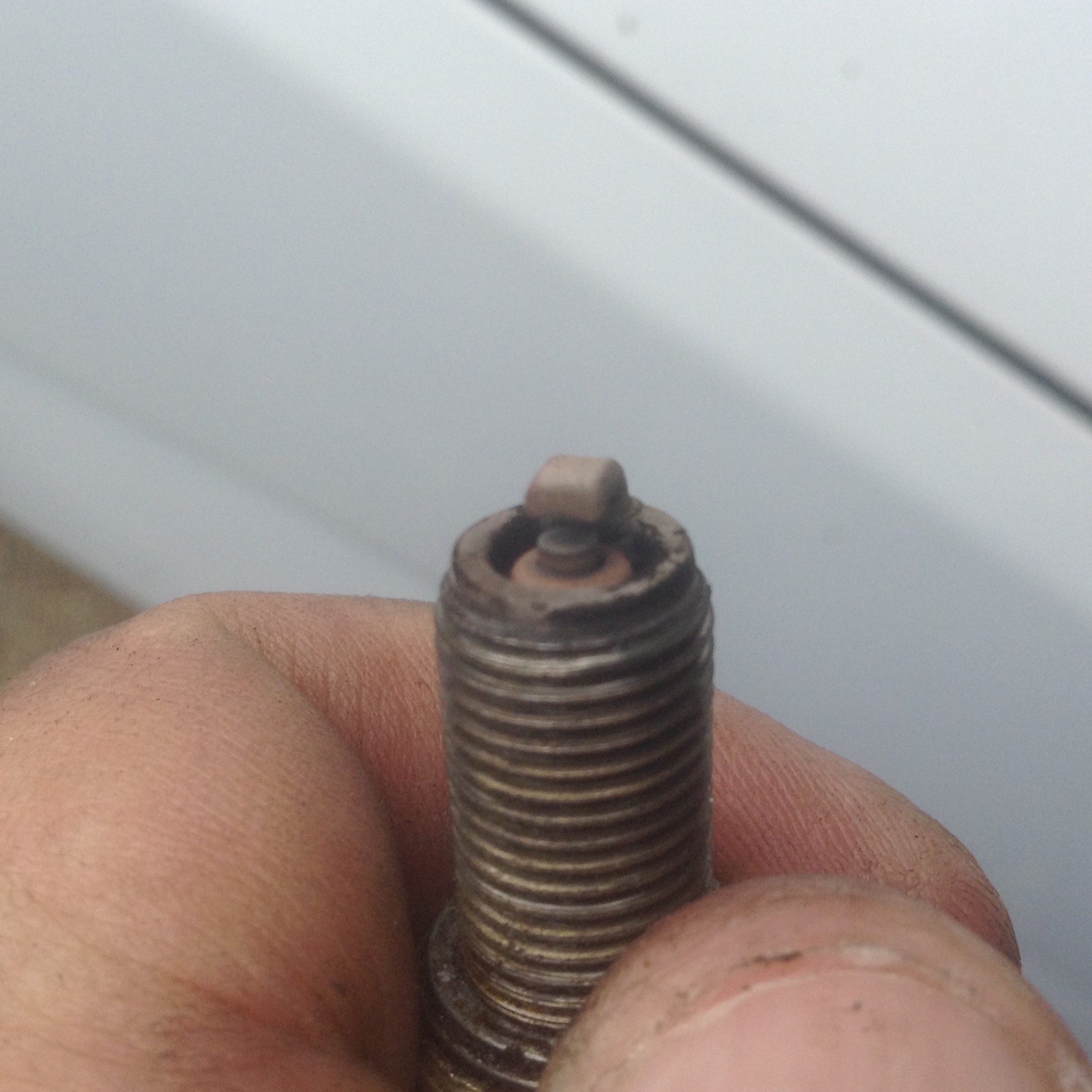

I did the MCM and bike runs great. If you notice, I scribed a faint line on the drive side of my cams before I did the MCM so I could clearly visualize the relative change in cam angular position. The lines used to be parallel to the valve cover gasket surface but now the cams can be seen to have rotated toward each other. TDC found with a plastic straw on piston and moving bike in 6th gear until I find it with both cams on base circle. Bike power has softened slightly in recent rides. Probably just my *** getting fatter. Valve clearance probably too tight. Plan to set new clearance near the max spec. Still have to look at the specs and calculate shims needed. Interestingly the spark plug shows little evidence of rich fuelling.
Perhaps there is room for improvement but getting 70 mpg if I don't hammer it is nice.
Edit: Just looked at the specs and the cam drive side is too loose, other side is still in spec but on the tight side. My guess is that the drive side cam bearing surfaces are wearing faster than the valve clearance can tighten up from wear. I wonder if a MCT set slightly loose would remedy that. Thinking about measuring the cam bearing clearances to see if anything is amiss. Should be between .001 and .006 inches. Now to find some plastigage in that range.
