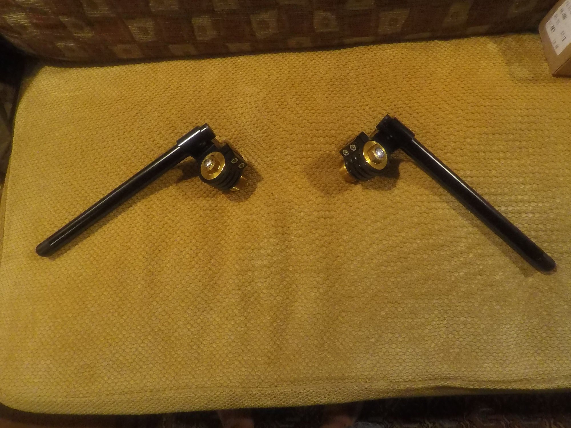

I drilled mine because the alloy bars are adjustable for both rotation and length in the clip on mounts.. I highly recommend the shorty levers. They're abour $20 off ebay.The perches are thicker and feel great.

It's my own idea. My KLX is actually the 3rd bike I've lowered with lightweight alloy clipons mounted directly onto the fork tubes.
Before the KLX I did my Grom...
...and my DRZ..

Yes, you're right. Sport bikes frequently mount the clip ons under the triple. The bars also slant downward. I didn't want a hunched over sportbike riding position so I put the clamps on top. I also turned the clamps upside down and reversed the sides so the bars were perfectly flat just like regular bars. And putting them on the tops of the fork tubes is like having low flat "drag" bars with no rise. The riding position is VERY comfortable.
