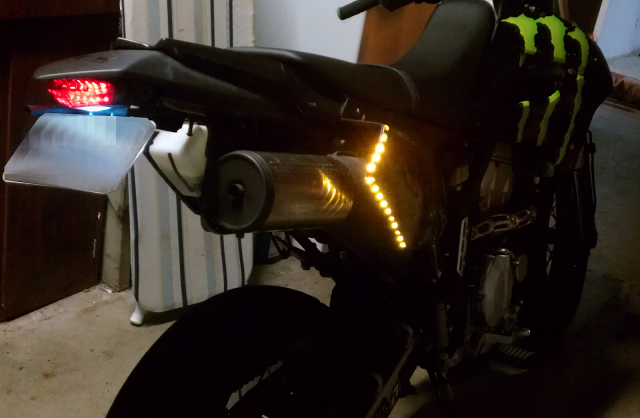

you can try integrated...it's illegal in california and i've heard of people getting fix-it tickets for them...i bought this one below before i found out it was illegal....
some people get really creative...

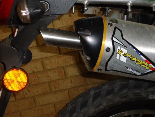

I had the same problem with my TBR M-7. I made my own tip from 1 1/2" stainless tube, about 5" long. It now needs a wipe once a week to remove minor soot build up.

maybe you could have just angled it down instead of extending out so far....

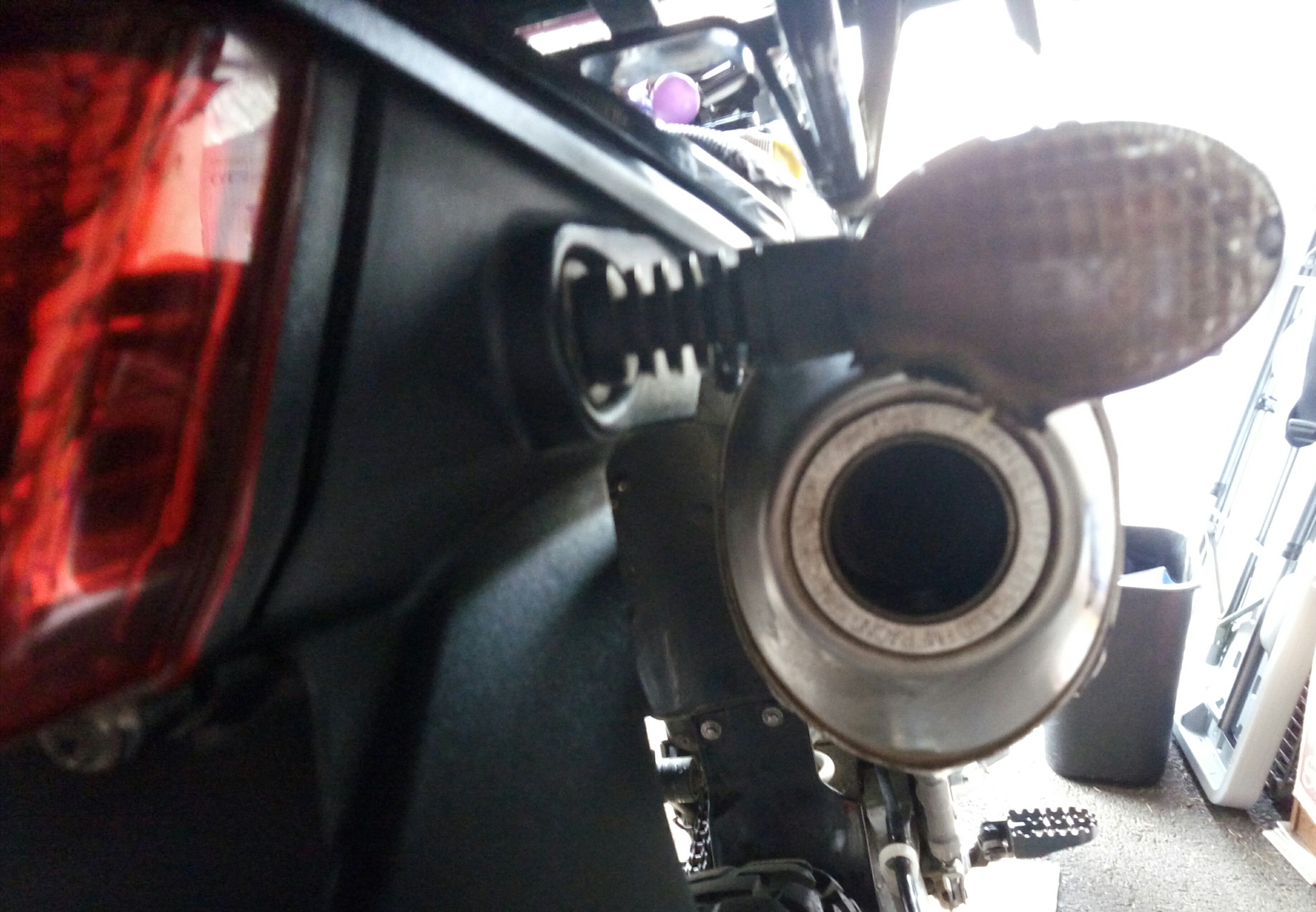

Default My melted klx250 signal
I'm going to try some narrower, metal bodied signals. Will let you know how they work. Hope image shows this time.
