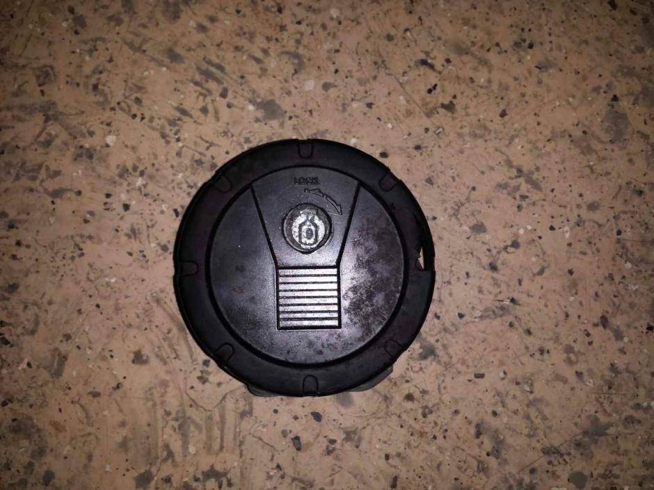

Ok, so yes there is definitely something jammed in there. I was planning on just drilling the lock part on the cap. The lock part is about 30 bucks, plus whatever to get it set up to work with my key, the whole cap is about 80. I like the idea of taking it to a locksmith now though. If I could find one around here I might do that. Right now I'm getting over a severe cold,, so it's going to have to wait a little. I'll let you guys know though and thanks for any input.

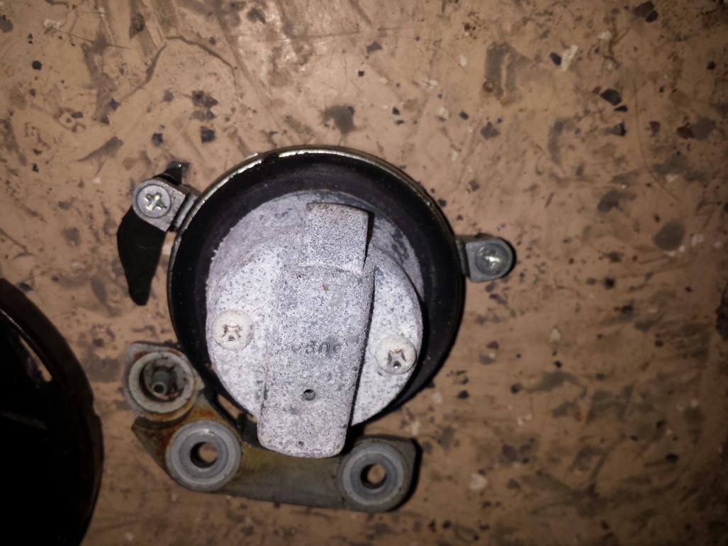

I drilled the lock out, but still couldn't open it. The one picture shows what the cap looked like after drilling. The next plan was to try and get the pin out of the hinge. A friend was trying to hold up the plastic so I could see the pin, but put a little too much pressure on it and plastic went flying off. So now the screws were exposed so I unscrewed it and the cap came off. It seems the cap was really corroded and that's why the key wouldn't unlock it. Anyway, it looks like I'll be getting a new gas cap.

Geez, what's the inside of the tank look like? I hope it's not as bad as the bottom of that cap. Glad to see you got it off. If the tank looks bad, then you have a great excuse to get the 3 gallon IMS tank. It comes with a new cap too.

The tank actually looks pretty good. I'm still debating on what I'm going to do.
