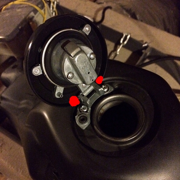

Good news, it looks like the hinge is removable. I hopped up into the attic and took a picture of my old tank. It looks like you can screw on a new cap. Have at it!
On a side note, do you know how long the bike was sitting with that gas? You may want to consider pulling the carb and cleaning it now while the tank is off.

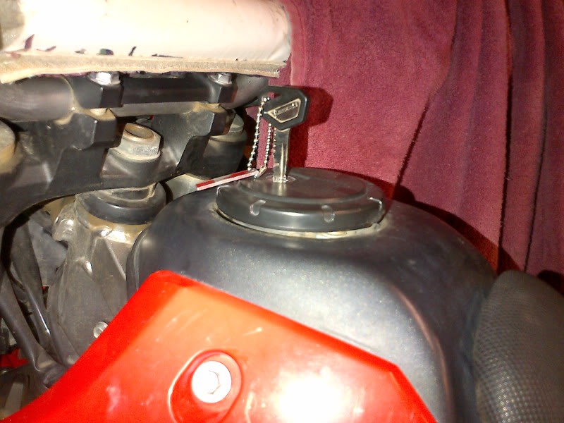

They DON'T go in all the way, only about 1/2 way in or less. You did verify the ignition key would unlock the helmet lock? If not, do so. If the key does not work on the helmet lock then it is likely the ignition lock was replaced, the key won't work on the other two locks (cap and helmet lock).

The key also doesn't go all the way it. It goes further into the helmet lock than it does the gas tank lock.

If anything, I would cut some notches to access there screws. If you can fix your lock, just replace the bezel of get some security screws to replace the originals if you feel the need.
