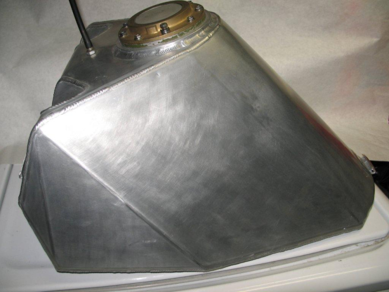

When we were racing we had to fix a leak in our oversize gas tank, a seam split and no bar of soap would rubbed in the crack stopped it. Emptying the tank then airing it out with a air hose was performed. Then a street bike was used to provide us with the needed oxygen free gases. A garden hose was put inside the exhaust pipe and started the other end was placed in the empty fuel tank. After a minute the hose was pulled out of the gas tank and a rag placed over the opening. Then kinda scared I asked how many times have you done this before to my buddy... Afew times was the response. Sure enough it didn't explode, but it still leaked so we had to do it one more time. I heard of this trick decades ago from Rob north a top fabricator.

Originally Posted by RaceGass
When your in a spur of the moment you do what you gotta do...
Not quite sure I'm following here. Are you using the hot exhaust gasses in a plastic tank to melt it a little and press the crack back together? Why a rag over the opening? To keep the hot fumes in?
So there is no oxygen in the tank, hence no explosion.
I get that, but what is being done to cause an explosion? Is that the next step, like a torch to the cracked seam?

Aluminum fuel tank. Similar to this. Purge the tank of oxygen w/ exhaust fumes then welded the seam. Scares you at first then you realize no oxygen no explosion. Anyone normally thinking... yes it's scary. Sorry to go off topic
