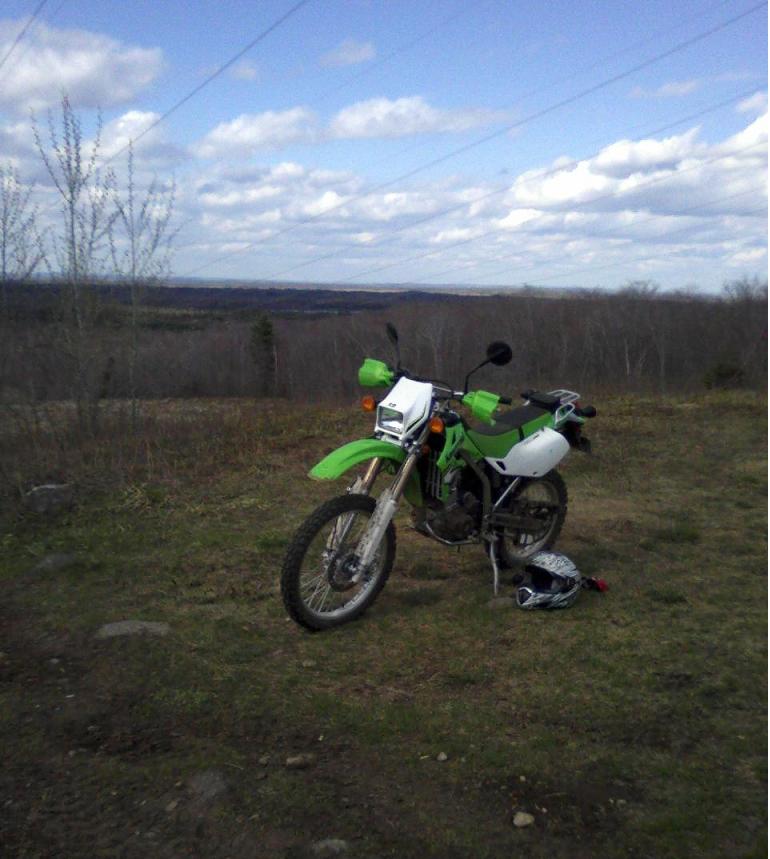

And before Deej falls on me, here is a pic of yesterday's ride. (Honestly, I am also testing putting images in a post).

I realize the picture in my top post did not make it in the post body, there was a link instead. When previewing the post I could see it in the body... What's the trick to have it displayed inline with the text? Sorry if this is an old question. May be I should ask in the Stupid questions thread...
