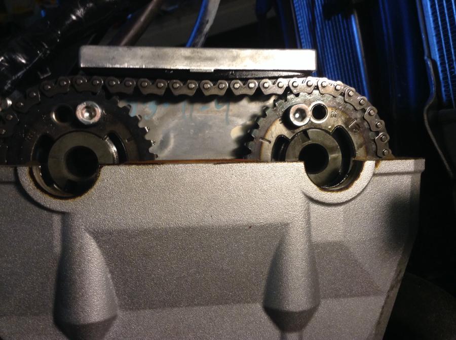

After installing a Galfer front brake semi-metallic pads and hose and bleeding it I ripped into the top end. No manual, just intuition. Cams are out and shims measured. I will need new shims, both interestingly on the drive chain side where the clearnces were too tight. Pretty easy so far. I lightly marked my cam ends so I can see the new cam positions regardless of the sprockets. I think I will just remove the ACR spring and call it done as far as it goes. But I did mark it too in case I decide to reposition it. And since the manual says: Check the valve clearance using this method only. Checking the clearance at any other cam position may result in improper valve clearance.: do we not need to alter the crank position appropriately to check clearances after the cams' timing is shifted WRT the crank? Perhaps not, just a question.
I think I can help a bit. No, there is no need to change from checking valves at TDC compression. I'm sure you realize the whole TDCC (Top Dead Center Compression) is to assure both cams are off the valve caps, max clearance will definitely always be at TDCC as well as a fair amount of rotation either way, but TDCC is absolute. The cam re-timing will not alter that fact. Clearance could be checked on intake at other positions as can exhaust, but on a single and most twins it is far simpler to use TDCC.
Key points will always be crank at TDCC and cams rotated to proper positioning with front run of cam drive taut, stock or MCM. I'd put the chain on, set cams in place and rotate intake back by hand the small amount to take out play, then look at the marking.
As I've said, I bounced around with the chain teeth, but nothing of any issue, the markings and positions are clear and obvious. If you are off a tooth or whatever it is quite clear. For me it was just the fumbling around of the cams fitting to teeth then re-seating in the head that caused the bit of issue with teeth - going the wrong way didn't help for speed of work. My other bike is shim over bucket so I never bothered with cams out and previous to that they were single overhead cam and push rod (MotoGuzzi) - easier to set up.
After the fact, doing the mod a second time would be a breeze.
I recommend since you are shimming, loosen the cam bolts while in the engine, then do the actual removal and shifting of the sprockets on the bench - no way to drop bolts in bottom end. In addition, suspend the chain with a screw driver so as to not drop it in the tower, not that it is a big deal, just some time getting the magnetic wand to pull it back up. There is no specific positioning on the chain, just the end relationship of cam timing/sprockets to the crank at TDCC. I remember someone was saying something about keeping the cam chain in exact position - it's an endless chain of identical links, no big deal.

It is done. Have yet to torque the cams in but the tensioner is in and my faint cam shaft marks look rotated as expected. Slightly adv on intake, slightly ret on Ex. My pic approximates the MCM thread pic. Darned bike shop doesn't carry shims so I had to order. Don't want to wait a week to ride my bike so I am throwing it back together and will install the shims I ordered in a couple of weeks. I do not think a few hundred more miles will burn a valve. I still have over 0.004" on my tightest exhaust valve. If anyone disagrees I'd like to hear about it. Pretty easy job. Only needed the manual for the specs. Thumpers are a lot easier than my V4 Honda on valve clearance. And the ACT is so easy to install compared to my V4 Honda. Gonna order me a Krieger MCT just because and my last thing is a new back tire. Intend to install at home with a home grown tubeless conversion. Going tubeless was the best improvement I ever made to my mountainbikes. Hope it is nice on a moto too.
First ride impressions: The cam chain is louder. Result of the work or just noticing it? I think it is louder. It was not this loud when I had the lid and snorkel in place. Maybe the ACCT needs to settle in. Krieger will get some money from me soon. The front brake is gonna take some getting used to with Galfer semi metallic pads and brake line. Faster, easier stopping than before and the pads aren't even broke in.
The MCM mod kicks ***. I guess I got it all right because there are no bad mechanical sounds from my engine up to 8krpm, intake noise is less obnoxious, and the front wheel levitates a bit easier with less rpm-clutch play needed. I think I need some time on soft dirt to get the feel for the balance point with softer landings when I go too far. Even without moving back in the seat I had the front off the pavement without trying to. Overall the MCM mod was pretty easy. I didn't even check my work afterwards. Just slapped it together and fired it up but did ease into the rpms bit by bit to make sure I didn't screw up, and I didn't. Will put in the new shims I ordered next week or so. Need to pop in the new larger DJ mains I received. She feels a bit more lean today. Will start small and work up to the largest. I raised my DJ needle to 4N/128 and lost a few mpg. Will be interesting to see how MCM affects economy. If I can stay off the throttle. If you have any curiosity about it, DO IT. The MCM that is. A very good and cheap HP booster. Now if I could lose 30lbs I would have a really fast bike.

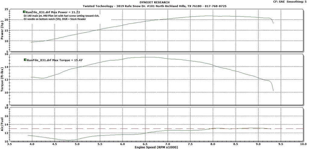

DJ doesn't make a pilot jet for the KLX250.. Just back out the fuel screw 3.5. to 4 turns until you get a 38 or 40.. 140/4N could get you that lovin feelin (of your bike doing a reverse cowgirl on ya in the middle of the street !) Also, with the 140, once you feel the WOT power from 7.5k on up, your addicted. You'll be making up reasons why you have to go ride.
I did a dyno pull with stock header + DGR and 140/5N - it went way too rich (a low of 10:1) from off idle to 6500 rpm (Here is the post - https://www.kawasakiforums.com/forum...-slipon-42907/),,, My local dyno tuner/dyno operator/shop owner says the notches are usually good for 1 full point of AFR - Point is that even though you'll love 140/4N, just know that you could be overfueling the midrange..

Yep, I know snappster.. But 136/4N is a "No-No".. Your midrange AFR @ 4N with the 136 will be well into the 14's - maybe close to 15:1.. Your bike running 136/5N is the 4th chart down in green - https://www.kawasakiforums.com/forum...-system-42926/
136/5N, perhaps, would make a good setup for you (and me) in the summer heat..
Your "holy grail" could be 140/4N - Below is my DGR chart using 140/5N , this is tantamount to your bike.. Imagine the midrange AFR on this chart(about 5.5k to about 7.5k) being 1 point higher with 4N, PERFECT! - Ignore the fat low end as that was an overly rich fuel screw setting on the #40 pilot
