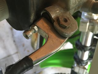

Thanks for all of the replies. It looks I can't actually adjust reach for the clutch and brake lever. On my KDX 220 there is a little screw I can use to adjust the reach. I'll probably wind up replacing stock with something that is adjustable.

Just curious on your observation here. You're saying your cable doesn't have a long...about 3 inches...threaded male/female segment in the cable housing somewhere...or a threaded male/female segment down at the clutch pivot arm where the cable goes into the clutch cover? That's probably unlikely. And there's not adjuster screw on the brake lever? I'd say that's unlikely too, but the possibility exists on a later model that I'm not familiar with. The clutch cable, however, almost absolutely requires some manner of adjustment in the cable even if it's from an aftermarket outfit.
I'm saying on my kdx 220, there is an adjustment screw right on the brake lever that adjusts the reach between the handlebar and the lever. Loosen the small bolt, move the screw in and out, tighten the bolt. I don't see anything like this on my '13 250s.
I'm always ready to admit I'm blind and just missing something. I'm not sure how much you can change the actual gap between the handlebar and the lever by playing with the clutch line housing itself. I thought that was primarily for setting the slack in the clutch -- how much play there is before the clutch actually engages. You are saying I can fiddle with the clutchcable housing and that will adjust the reach?

LOL!...no, not suggesting you're blind on that brake lever. Like I said, I haven't seen your model master cylinder/brake lever. My '06 has an adjuster there, but apparently they dropped it later.
