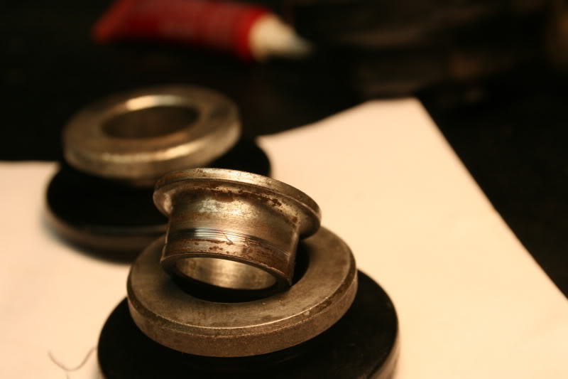

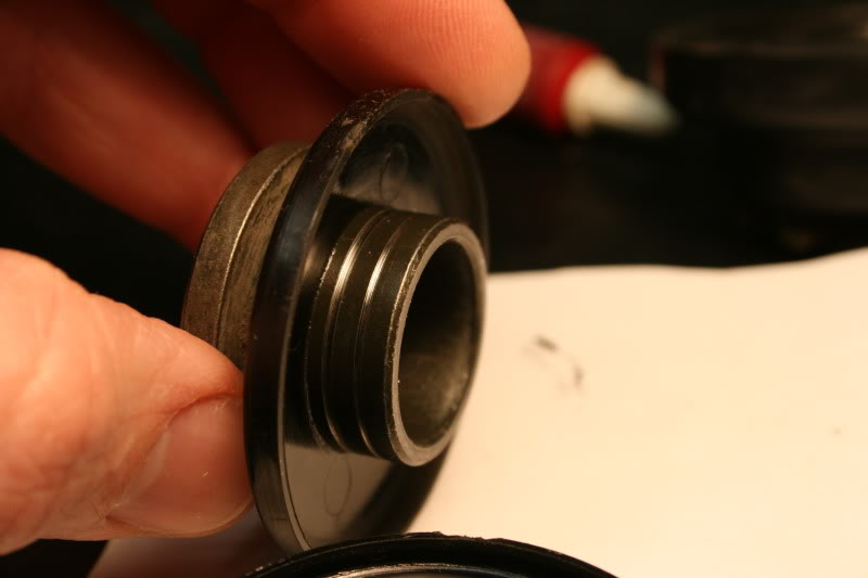

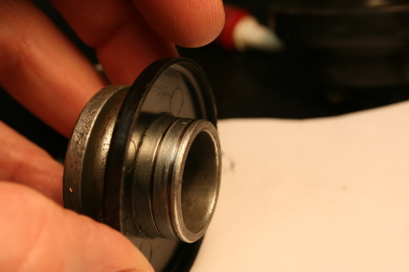

You may already know this , but Just the act of knocking bearings out, ruins them. You are whacking on the inner race and it is transmitting all the force to the ***** which then transmit the force to the outer race. All of that will cause small dents, or brinelling of the races, which will cause the bearing to fail much sooner.
My spacers do have wear grooves in them , I don't know that they are too deep? I think the seals have quite a bit of play. After you posted your pics I went and looked at mine. There is some type of defect in the front wheel spacer, some type of a crack, or void. Maybe I will look into replacements.
Dan
