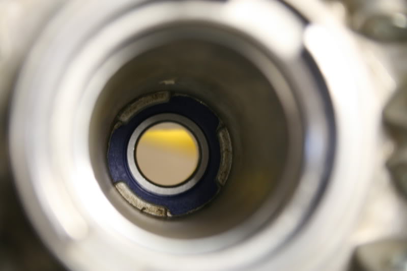

Don't forget to put the spacer in before you press the other bearing in.
The dust seals can be pressed in with your fingers.
