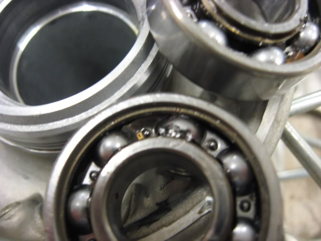

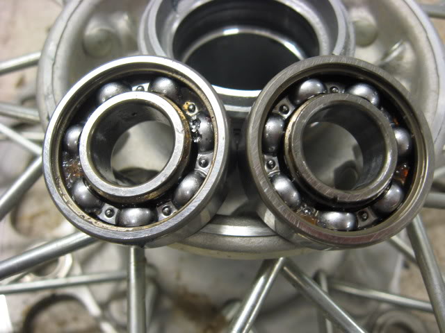

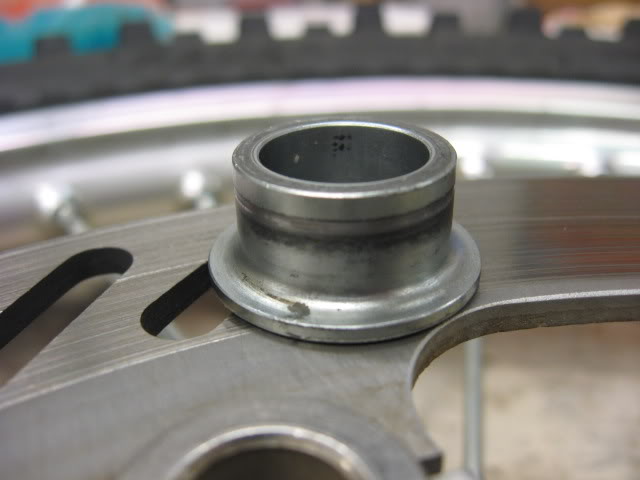

Ahh, shucks.
My bearings looked great. But fubar'd one on the way out. So, new bearings anyway.
But, this part is worn. It has a wear groove. How was yours?
Hit a bearing with the drive to get it out. Oh well.
