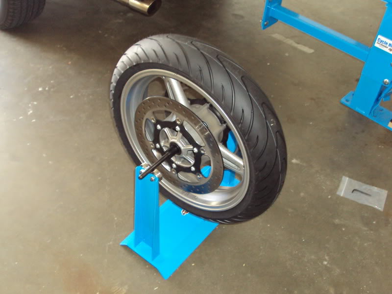

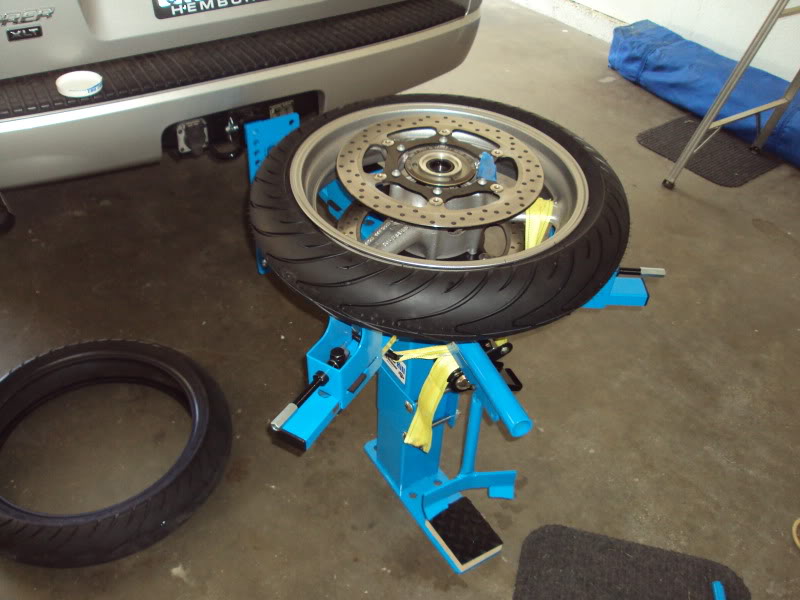

I have a NoMar/Cycle Hill changer and balancer set up in the garage. Makes changing tires a breeze.

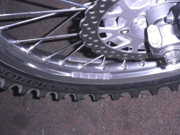

Balancing it for the added rim lock. This is what I found at a tire shop, any other options available?

Another recent thread shows the weights that crimp onto the spokes. Way less likely to get knocked off. And reuseable.
Found it
https://www.kawasakiforums.com/forum...55/#post454210
