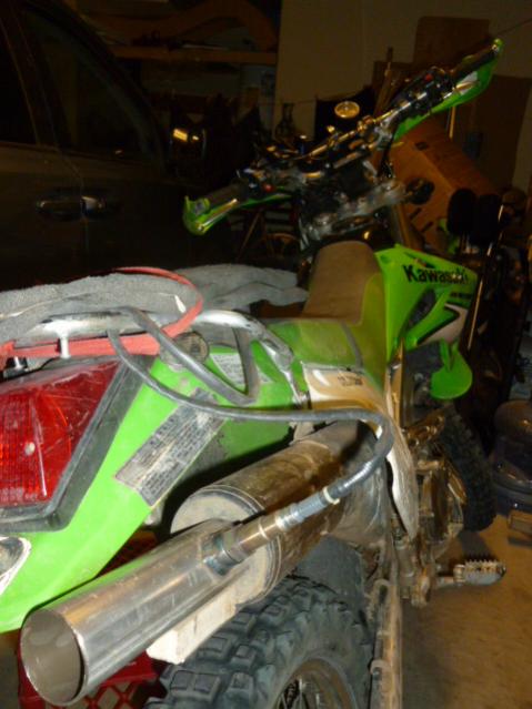

OK, got the (Fuel to Air Ratio) wide range sensor installed and headed out to the biggest hill around I-17 south from camp verde. It took a while for the sensor to burn in as I was reading initially around 19-20. After burn in it went down to 13 WOT @ about 70mph-ish. Way to rich. MJ 135 (I thought I had a 130 in it, but not. Boys remember to write these things down as they are important).
Changed MJ to 125 and hit the road again, only I didn't go back to the big hill, the gauge will settle in pretty fast so picked a shorter hills around the house.... reading went to 16.5 ish on WOT in acceloration. The engine was stumbling a little on WOT. It pulled from idle very crisply though and at part throttle at normal speeds the reading were in the 13-15 range.
Therefore, I beleive 130 will be very close. I think I'll take the bike up to 7500ft elev and see how it goes next week though before I do anything, I am thinking of taking it to CO in August, so I may just live with it till then.

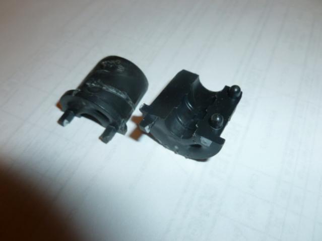

Putting the bike away I found the part in the picture... anyone know what it is? It is suppose to snap together around a cable/hose/wire? and then it may be a grommet? It may be off my bmw 650, if it is.. now I am worried.

jhoffy, I see the part you are holding up, but not very clear. The part I have when you get it hooked together has a smooth exterior cylinder shape like it is a grommet for a cable that passes through it, then it goes in a hole.
That is near the rear of the bike, where I was messing with it, but where does that thing you are holding up go?
