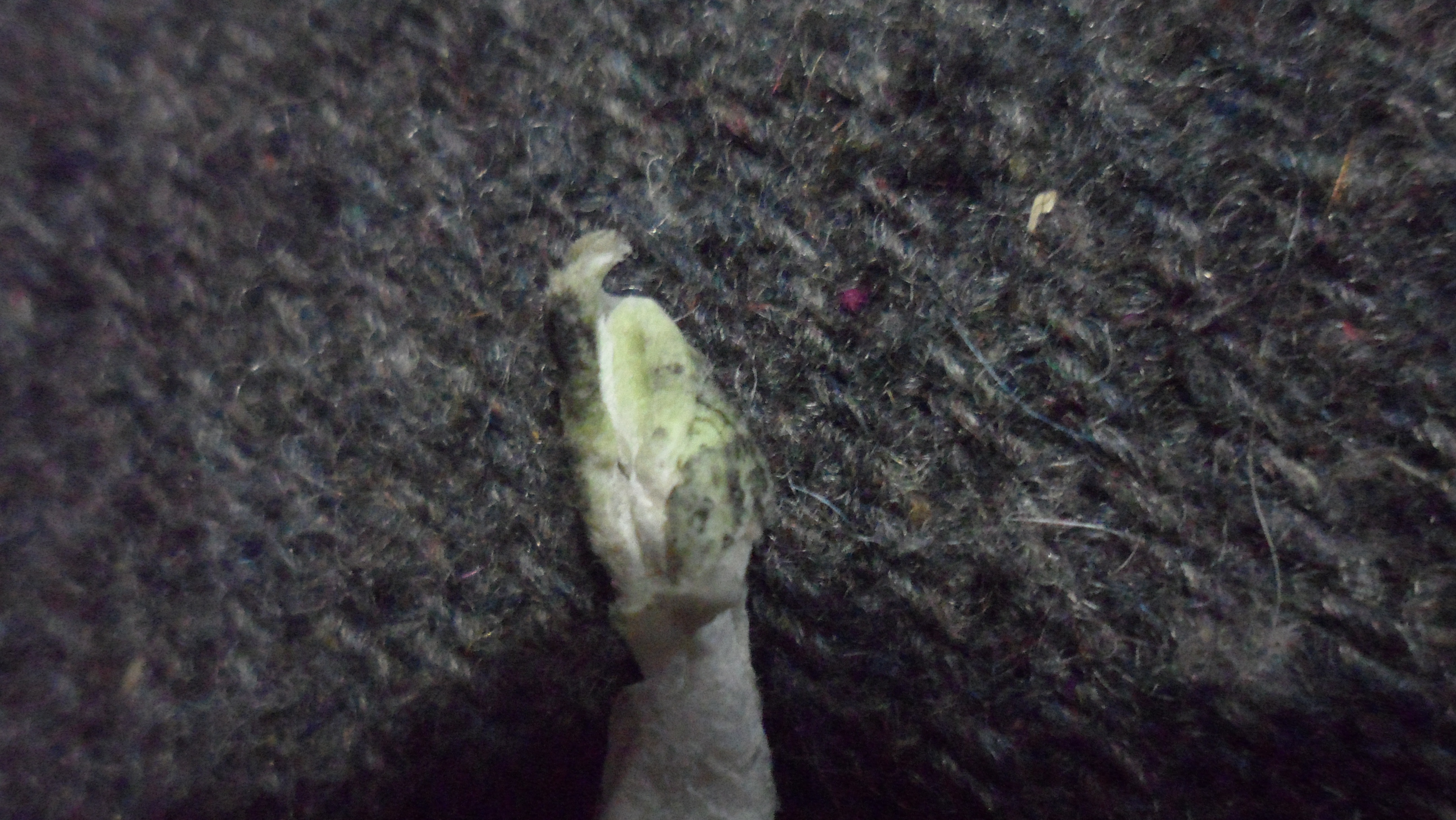

Just went to go put tape over the hole when I saw the coolant inside with a light
Stuck a paper towel deep in the hole
Not much in there but it is in the whole
I doubt any other leak somehow made it into that hole

about the size of a q tip

around 1100 miles so far
from the last time I had posted about the small leak I cleaned it all up
this is whats has came out since
reserve tank still very close to the mark I originally made
but depending on how hot or cool the bike was when I did the mark it could change slightly
