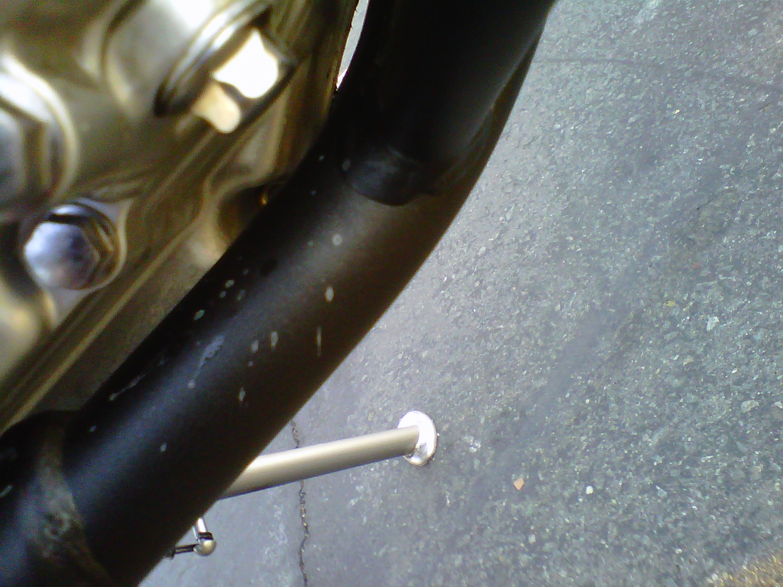

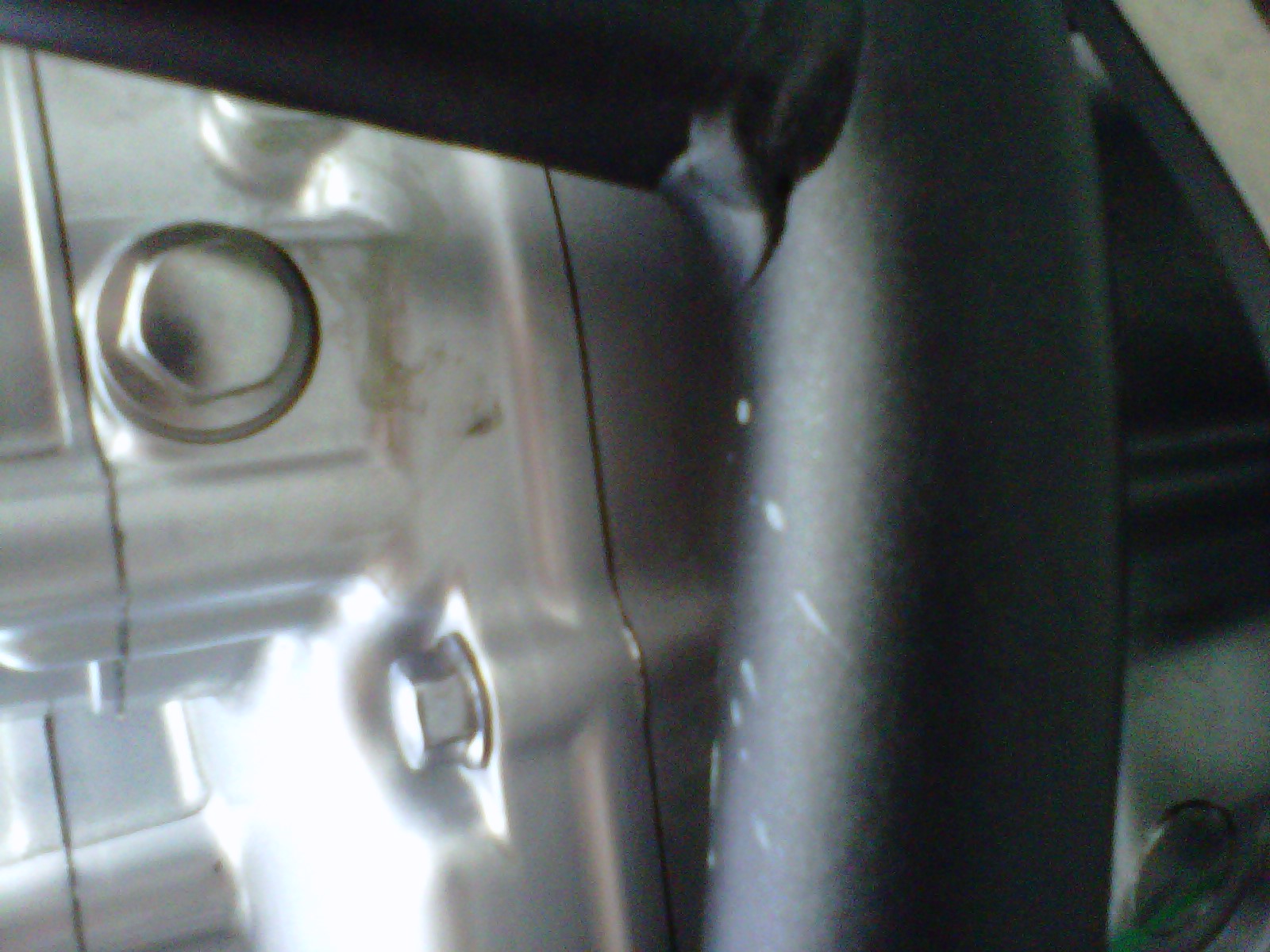

well its leaking for sure
noticed some white spots on the black tubing
looked under and its wet
not alot, about a drip worth but I would think it may be a sign it could leak more
New pics

Sucks dropping 5 grand cash on a new bike and now I got to waste time driving 45 min to bring it in for service and get it back who knows when

Okay here is what happened
Dealership looked at it and said why am I bringing it in. At the time it was dry. No new stains. Showed them all my pics of before. Also said about the stains on the bottom of the radiator, those black plastic fins and radiator cap. He agrees with me those stains may have been from coolant leaking out from the cap, if it wasnt tight or something.
The weep hole he didnt seemed concerned about. Said only bring it in if its actually dripping out.
I never had seen it dripping only once a tiny wet spot and those stains.
He said drive it until it blows up, and keep an eye on the level.
So I guess either they dont want to work on it, or its normal????
They did say they would take it apart and clean the pump out, but whats the point of that I can do that myself.
So I will just keep records of anymore stains, marked my overflow bottle to keep an eye on the level. Maybe in a few weeks pop the cap to verify its full.
