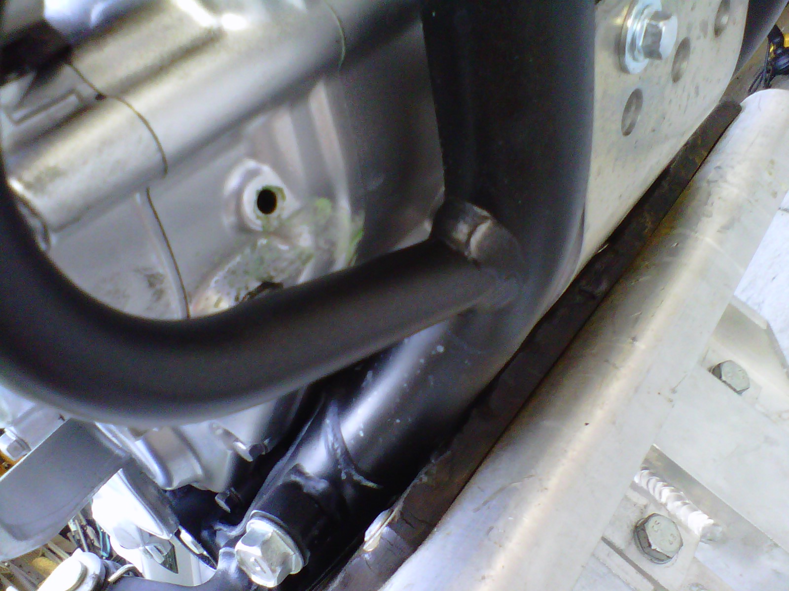

Brand new 2012 klx 250s
Noticed on the bottom of the right side radiator dried up coolant, along with on the filler cap. Crusty gray green residue.
Then under the water pump there is a small hole with the same residue.
Now I noticed this today with around 180 miles on the bike. And have not seen or smelled any coolant yet. Just now cleaned it up to see if it comes back
Im hoping maybe the radiator overfilled and ran down the front, and down the hoses. Maybe from dealer prep? Then dried up.
Now there is no reason to have any coolant leaking out of that pump drain hole correct. It would only leak if the seal or something was bad?
So far overflow container looks to have the same amount of coolant in it from when I got the bike but I think I will make a line on it to see if it changes too much from hot to cold.
Thankfully I have 1 year warranty on the bike
Also saw one of the bolts on the cylinder the coolant hose connects to had a drip of what looked like oil on it, but if its a coolant passageway bolt I would think if anything it would have dried up coolant on it. Maybe its just oil from something else?
Really need to look over everything on this bike I guess
Hopefully these arent future problems

If I'm reading you correctly, this is a brand new bike, right? Not sure I'd get too excited at the moment about the presence of fluid residue immediately. Clean off those spots of residue, and then keep a close eye on them to see if any more fluids show up there.

If you want to check for small drips of coolant out that hole, take a small balled up piece of paper towel and tape it over the hole. Ride and then inspect the paper towel.
