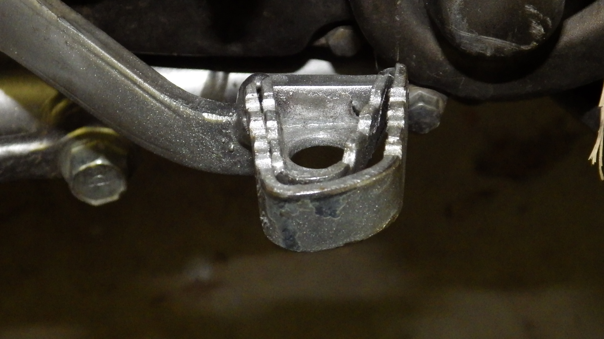

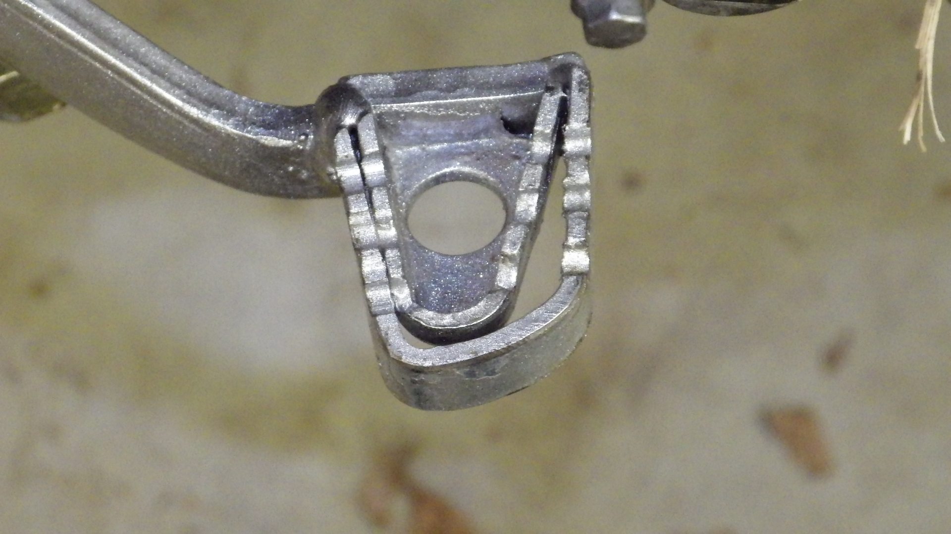

I took the advice of several posters. Mike of Mike's RE-Cycles of Adams, Ma. made this little bracket and welded it on. It works like a charm. Thanks to all.

Looks great. Thanks for the follow-up.
