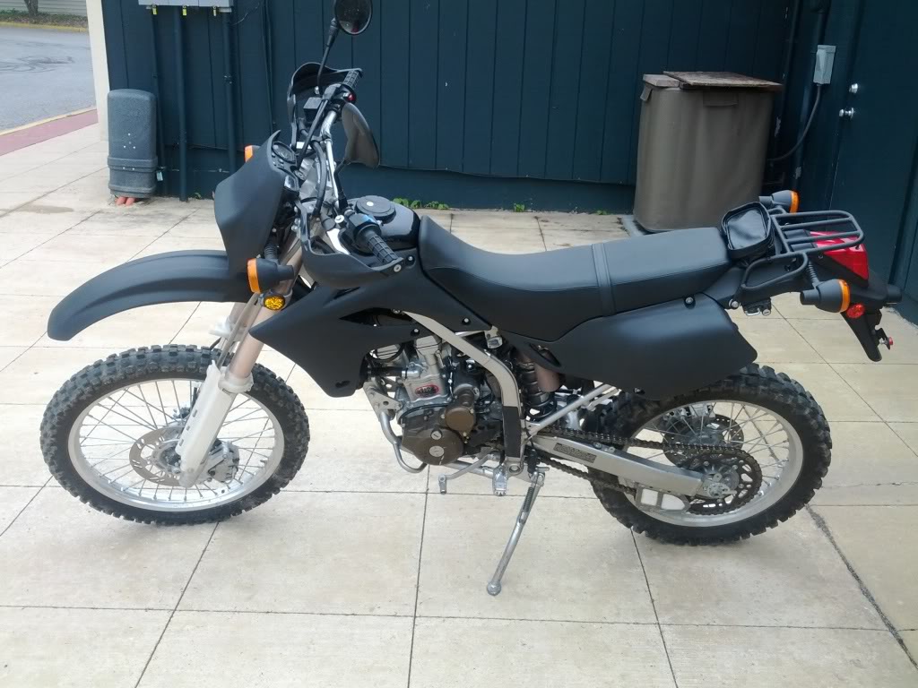

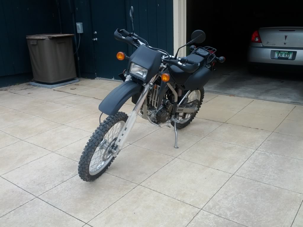

here is some pics when I got put all the plastic back on.

From: Guelph, ON
How did you do the plastics?
I really like that look!
Maybe just some fine grit sandpaper?

bed liner spray paint...from what it looks like...

yea a few coats of bed liner spray paint and used fine steel wool between coats and after last coat to take off the rough texture.
Dupli-Color TR250 Truck Bed Coating Aerosol and
and Dupli-Color HVP106 Flat Black High Performance Vinyl and Fabric Spray on the seat. I roughed up the plastic and put a coat of krylon black plastic spray paint before the truck bed spray paint. Everything looks brand new like I bought it that way =)

I was thinking since my bike is already all black.. just sanding down the glossy finish of the plastic... I have no experience working with plastics though...?

well you could always try that and if it didn't look good you would probably only need one coat of this stuff then if it's already black. it's really hardy stuff so far...I already hit a piece against a machine in my dads shop and it didn't show any green.
