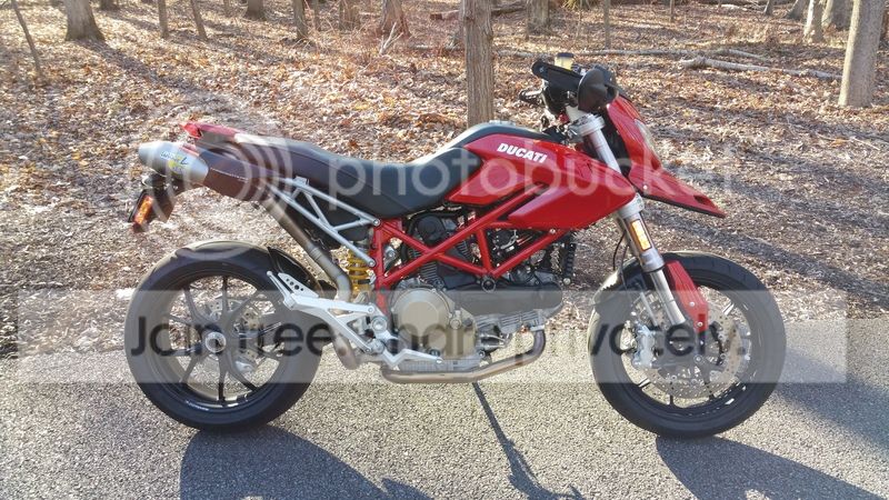

Werloc, do you still have yours? Mine is the first year 2008 and I still have it. Here is the most recent pic from earlier this year
Mine was the same year 2008 as yours. I bought it in march of 2008 and sold it after my 2nd failed back surgery late 2011. I ended up in a wheelchair for almost 5 months and thought for sure my riding days were over. Only the passed 3 years I'm back to riding. Man do I miss that bike. Hands down the best street bike I ever owned. And I've had many over the years. But my heart is riding dirt.
