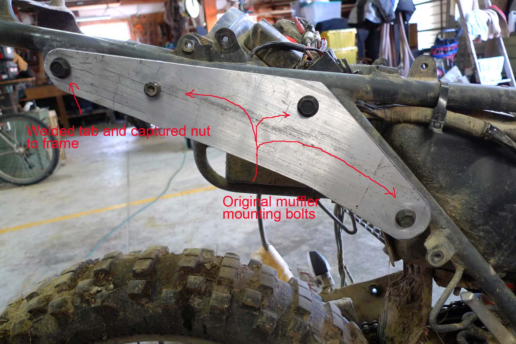

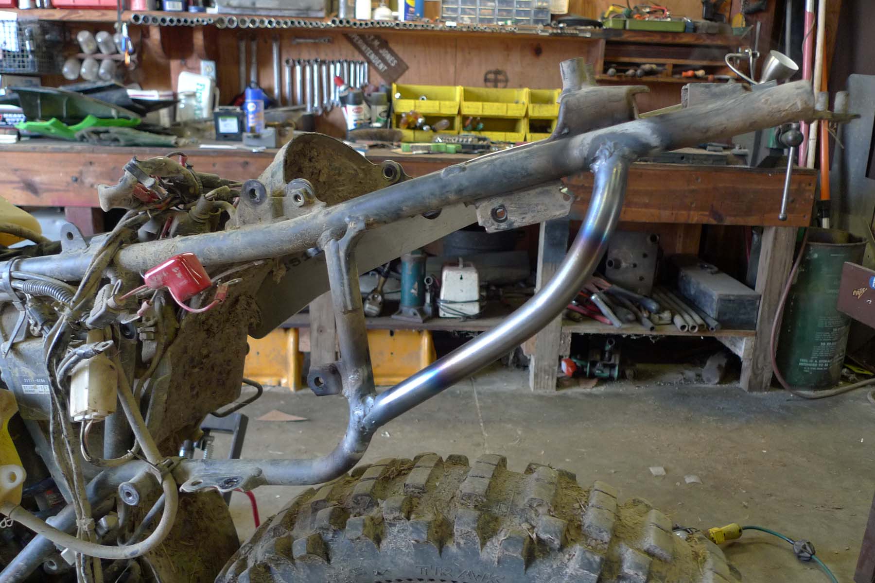

Here are two of the mods I made to my KLX250 to ready it for our recent trip to Colorado. The left side needed only an extra tubular brace to extend the truss of the subframe.
The right side is more vulnerable, in my opinion. A stock bike's subframe is reinforced by the stock muffler. The muffler has three mounting bolts that span the weakest part of the right side subframe. Most of us, including me, are running aftermarket exhausts, which mount with only one bolt, which contributes nothing to the frame strength.
I fabricated an aluminum plate to simulate the effect of the original muffler, and went ahead and inserted a 10-inch piece of tubing into the right top member of the subframe. There's a slight bend in the subframe at this point so you need to prebend the reinforcing tube before driving in. You only get one shot. It would be very difficult to remove the tube.
We rode over 500 miles of rough Colorado trails with multiple crashes and I had no trouble with my subframe. It supported a luggage rack holding a pelican case, 2 tool tubes, a large duffle and 2 saddle bags, all weighing about 50 pounds.

This is perfect! Thank you for the pictures and details.
On the right side I got the Japanese-made black brace. It doesn't look quite as long as yours though.
Regarding the reinforcing tubing inside the frame. This will probably sound incredibly stupid. With the pre-bend, how can the tube make it all the way down the straight portion of the frame when it has a bend in it?
I fabricated an aluminum plate to simulate the effect of the original muffler, and went ahead and inserted a 10-inch piece of tubing into the left top member of the subframe. There's a slight bend in the subframe at this point so you need to prebend the reinforcing tube before driving in. You only get one shot. It would be very difficult to remove the tube.
Not stupid at all. As you drive it inside the subframe tube it will straighten out, but will retain some residual stress that will help it conform to the slight bend in the subframe when it reaches it's proper position. Or, forget about the pre-bend and drive in a straight tube. It will impart a certain amount of stress into the bend of the subframe, though, but may not matter. Thin wall 1/2 inch metal conduit is close to the right size.
Yes my right side brace is a little longer for extra strength. I also had to weld a tab further back on the subframe to accommodate the larger brace.
