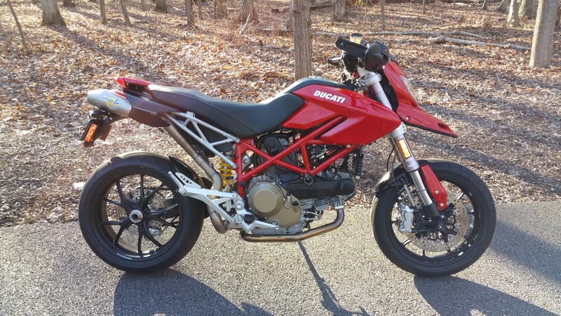

Werloc, do you still have yours? Mine is the first year 2008 and I still have it. Here is the most recent pic from earlier this year
