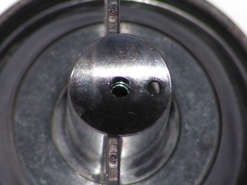

Drilling the slide is a simple task.
If you look at the bottom of the slide you will see two holes.
The one in the center of the slide is where the needle slides through - DO NOT DRILL THIS HOLE!
The hole nearest the edge of the slide is the one you open up to 7/64ths in size.
This hole is what provides the 'signal' to the carb to open the slide. On a CVK34 carb, the engine vacuum is used to determine how much to open the slide once the throttle is opened up. The hole you drill sits closer to the intake valve and thus can sense the amount of vacuum the engine is producing. The amount of vacuum needs to be sent to the chamber that reside on top of the diaphram. This hole is what lets that vacuum get there. The bigger the hole, the quicker the slide opens. Now, don't get carried away, put that 1/2 inch drill bit away, as you can go too big. More than 7/64ths and the throttle gets very critical. When you touch it, it jumps both on acceleration and deceleration. It can become too touchy. I've chose 7/64ths as it seems to improve the throttle response, but not to the point of being obnoxious and hard to work the throttle smoothly.
Hope this is what you're looking for.
Any other questions, let me know.
