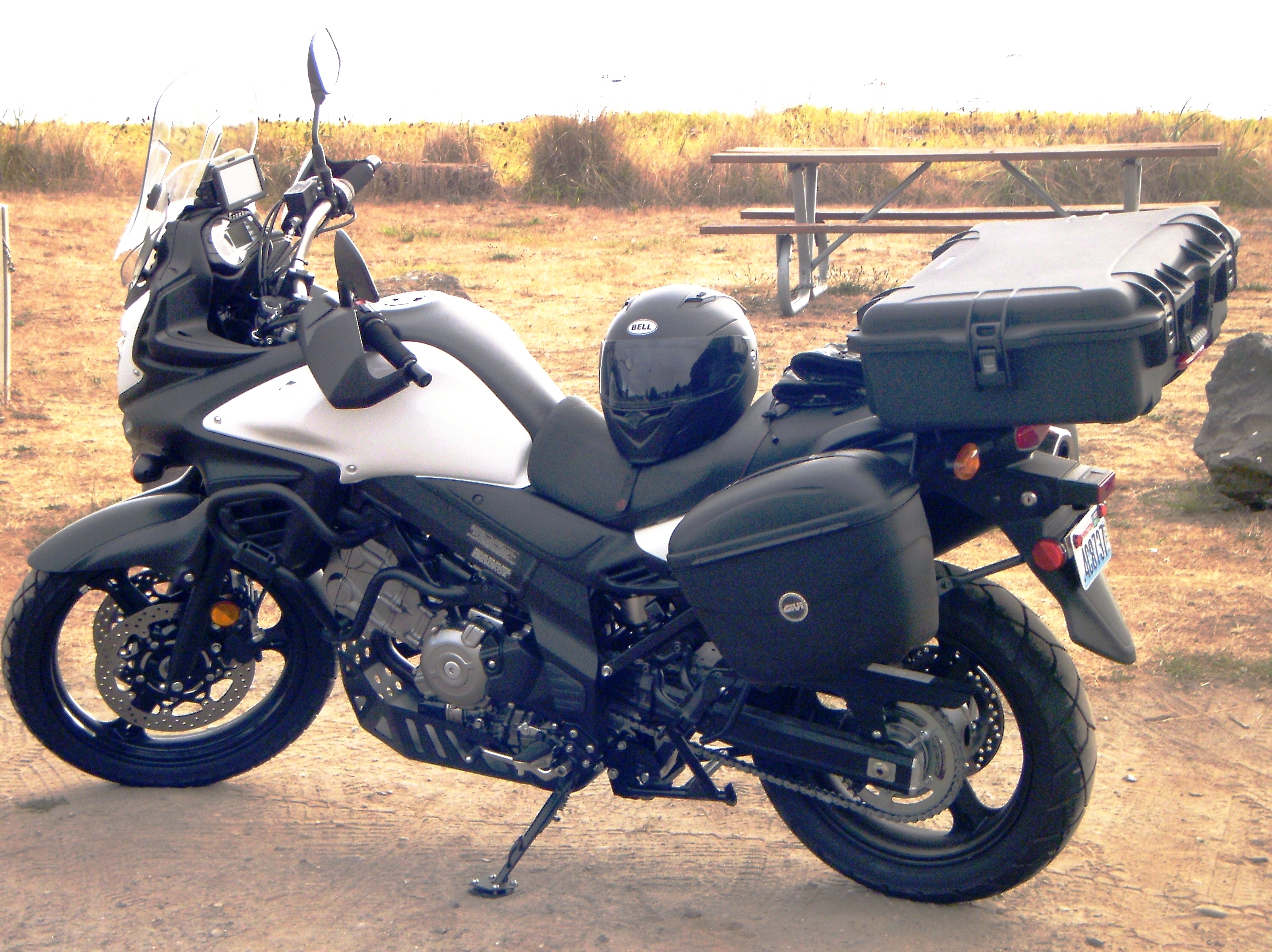

Thanks for all the information. I assumed it would increase the vibration, I was just wondering if it would get as bad as the big thumpers of my youth. The hopped up XR600 of my past seemed to bounce the front tire on every power stroke at idle. Maybe I will just stick with stock bore, MCM, piping and jetting. Still working on taming some of the vibes on the VStrom, though it hasn't been ridden since I got the KLX.
