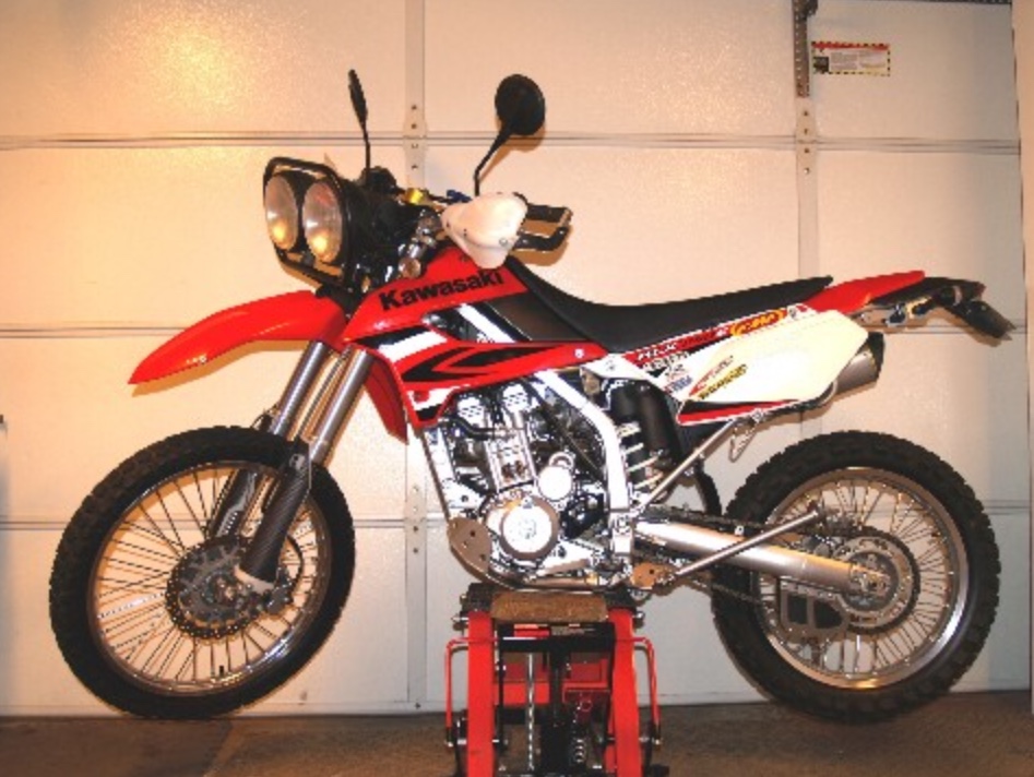

I ran two 55 watt halogen cibie Oscar plus (very old school) lights with no problems on an ‘09 klx. I was gonna try a 100w bulb in one light but a member here Tremor advised against it as he had experience with over loading the electrical capacity on his bike. Baja designs rewinds klx stators for 130 watts output.
Attached Thumbnails Alternator /stator output-f33face0-3fa4-4581-b7c7-121f52affa95.jpeg
