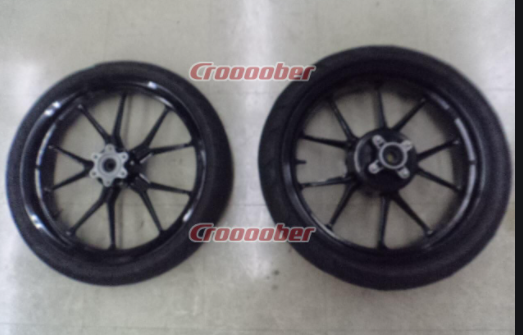

I definitely prefer the solid wheels instead of spoke wheels so in my research I found that Marchesini offers Forged Supermoto Wheels that looks perfect to me but the cost is crazy.
