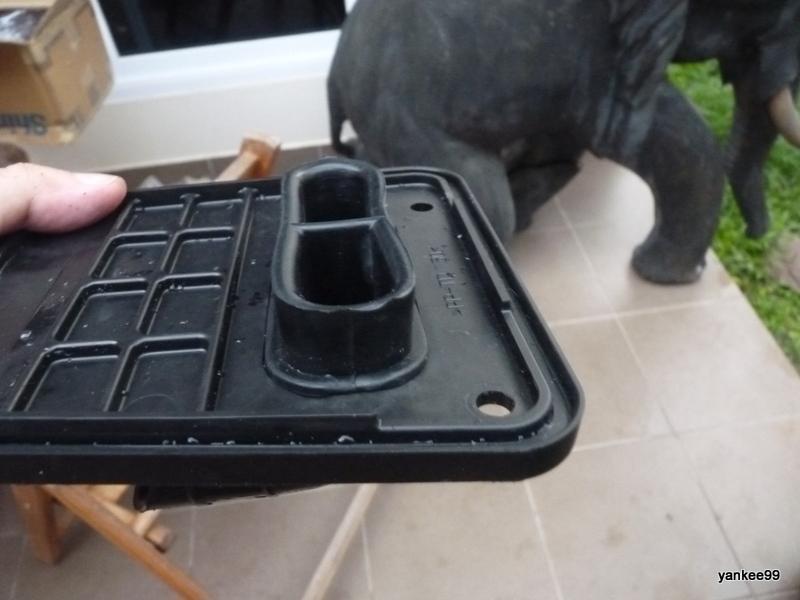

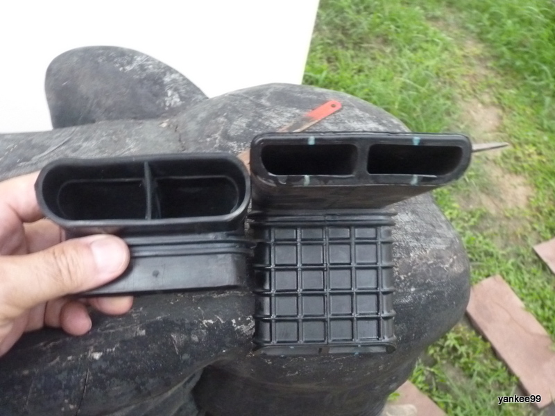

Yesterday my boss 175 snorkel arrived at the dealer 275baht ($8.75)
Old one on the right new one left...Big difference...

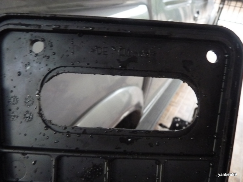

A quick mod of the lid with a file....about 5 minutes

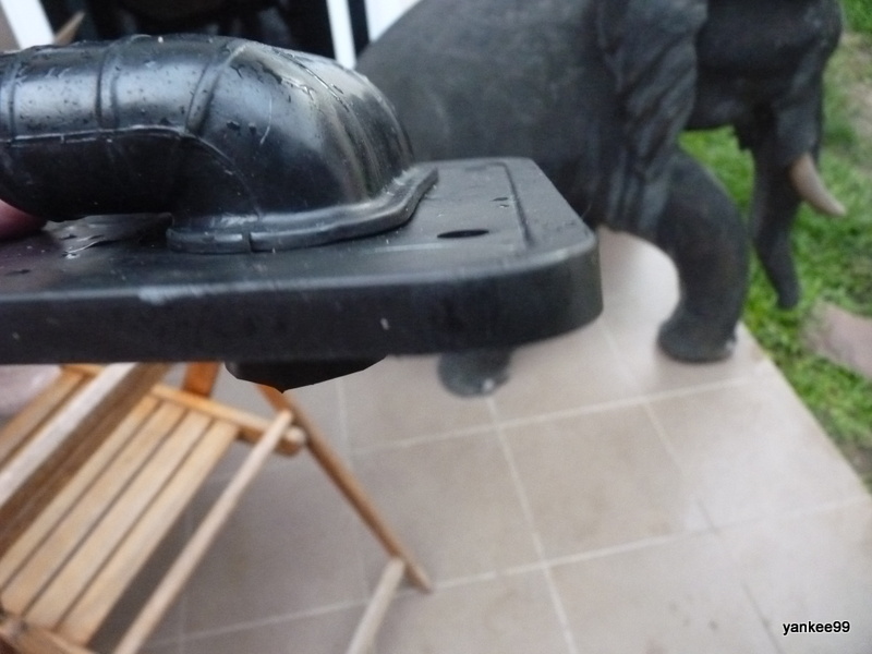

Then in goes the new improved snorkel

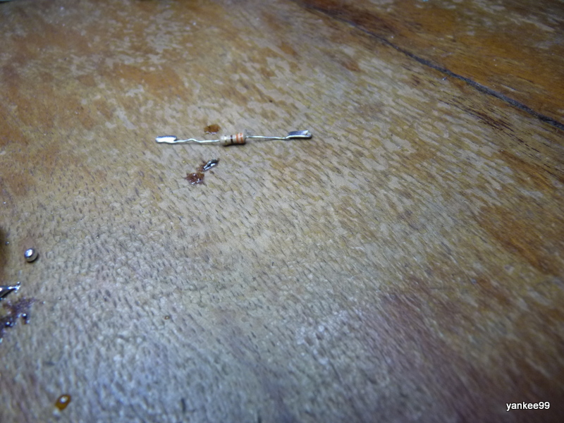

I also needed to Mod the o2 sensor or the bike would run lean...thanks for all the info on the forum...
I purchased 2 330ohm 1/4 watt resistors to insert in the o2 plug....I soldered the ends to make them fit nice and snug in the female side....

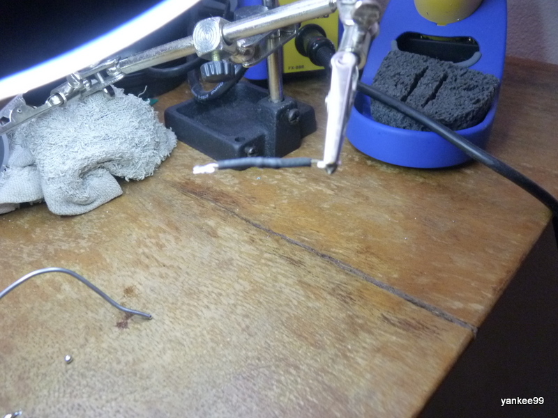

I then added some heat shrink tubing

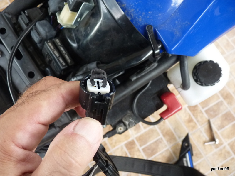

I inserted them and covered everything with some electrical tape....Doing it this way i theoretically could return the bike to stock if it had a catastrophic failure...
