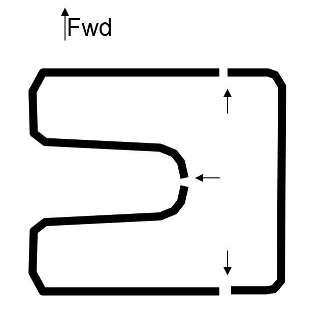

So. Thought you'd like the solution. If this had happened on a normal day and I could have bought a gasket, I would have. But this happened on a Saturday afternoon after the dealer closed, and I needed the bike Monday. So I thought I'd try something anyway to get it together. If it leaked, I was going to buy a gasket (and WILL at the next valve clearance check).
BUT... I was really trapped so I thought about the situation. And after thinking it through, here was my fix; I cut the gasket at three stratregic (symmetrical) locations as shown in the diagram below. This immediately allowed the gasket to be inserted properly, and due to the shrunken nature of the gasket, left three gaps that were now unprotected (arrows). I put a dab of blue silicone RTV at each of the cuts and put it together. Let it sit Saturday night and Sunday night I fired it up - (also rode it 60 miles today)... and no leaks!
So it's a corny fix, but I'm thinking I'm set (and nice and clean, finally!!) until the next valve clearance check. It was a breeze to assemble this way. If the gasket had been the right size, it wouldn't have required any cuts of course.

Nice fix Watt-man. Thats using your head.......and some silicone. Sad that Kawi doesn't stand behind their product. Looks like a well documented flaw.
