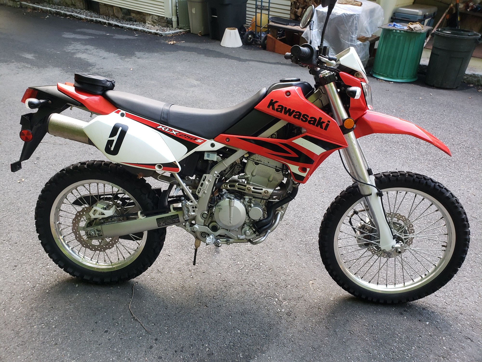

so i just bought a 2009 klx completely stock with low mileage and though it seemed "perfect" when i bought it i have noticed a couple of things i would like to correct.....
1- chipped paint on the motor and would like to make that look better... just paint it maybe? is there good match, i have read (i think on here) that
duplicolor de1650 ceramic cast coat duplicolor de1650 ceramic cast coat
aluminum engine paint works well) any other suggestions or ideas?
2-some various chips on other silver/aluminum parts which look to be the same color as the motor and some black parts also looking for a good match of course 👍
3-it seems that when i am on the trails first gear seems like it is revving a bit to high and second is chugging and lugging, what gives there? is there a fix or other wisdom?
4- the left rear directional was broken (including a right angle piece) and though it works i would like to fix it, dont care to much about it being stock but prefer function over form....
5-the brake lever was bent and would like to rplace it where can i buy an inexpensive relacement?
thats about it... i do love to turn a wrench on my bikes, cheers
my new to me klx250!

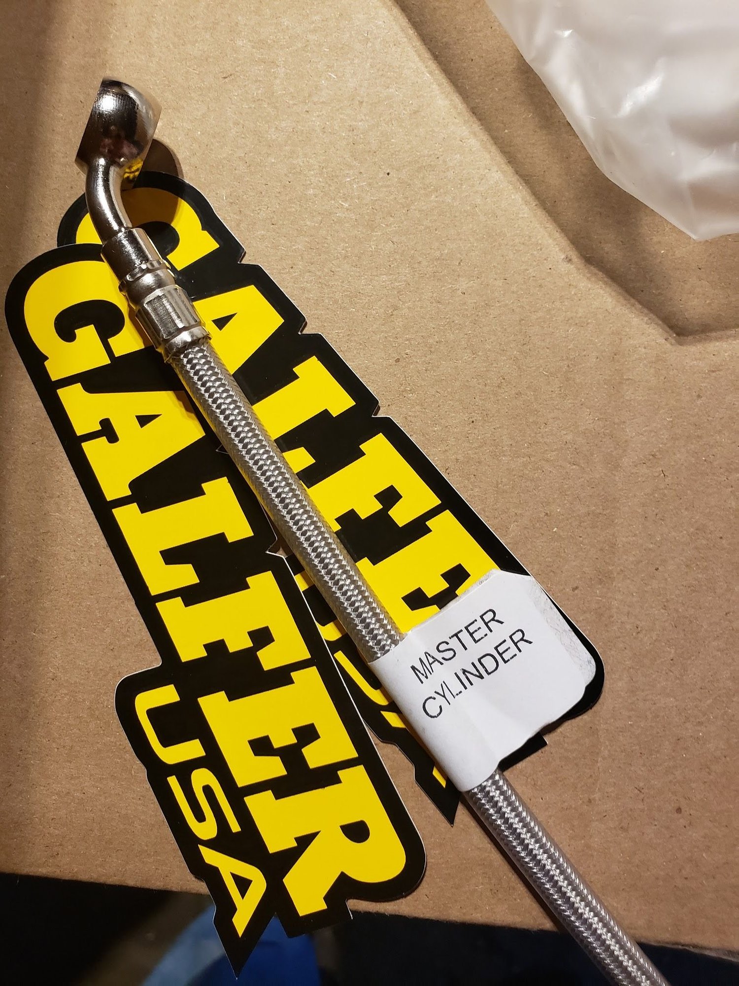

i completed the front brake line and foot pegs. i used galfer ss braided line.

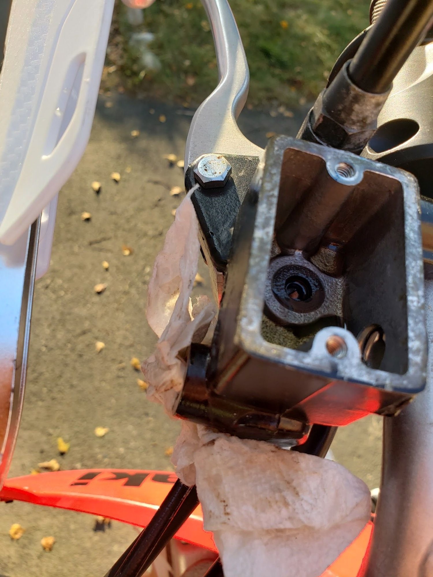

the master cylinder cover screws were fairly soft and i recommend JIS screwdrivers, vessels are reasonable on amazon. took alot of bleeding to get the air out ....maybe my imagination but the modulation seems better now... either way the front brakes work great now.

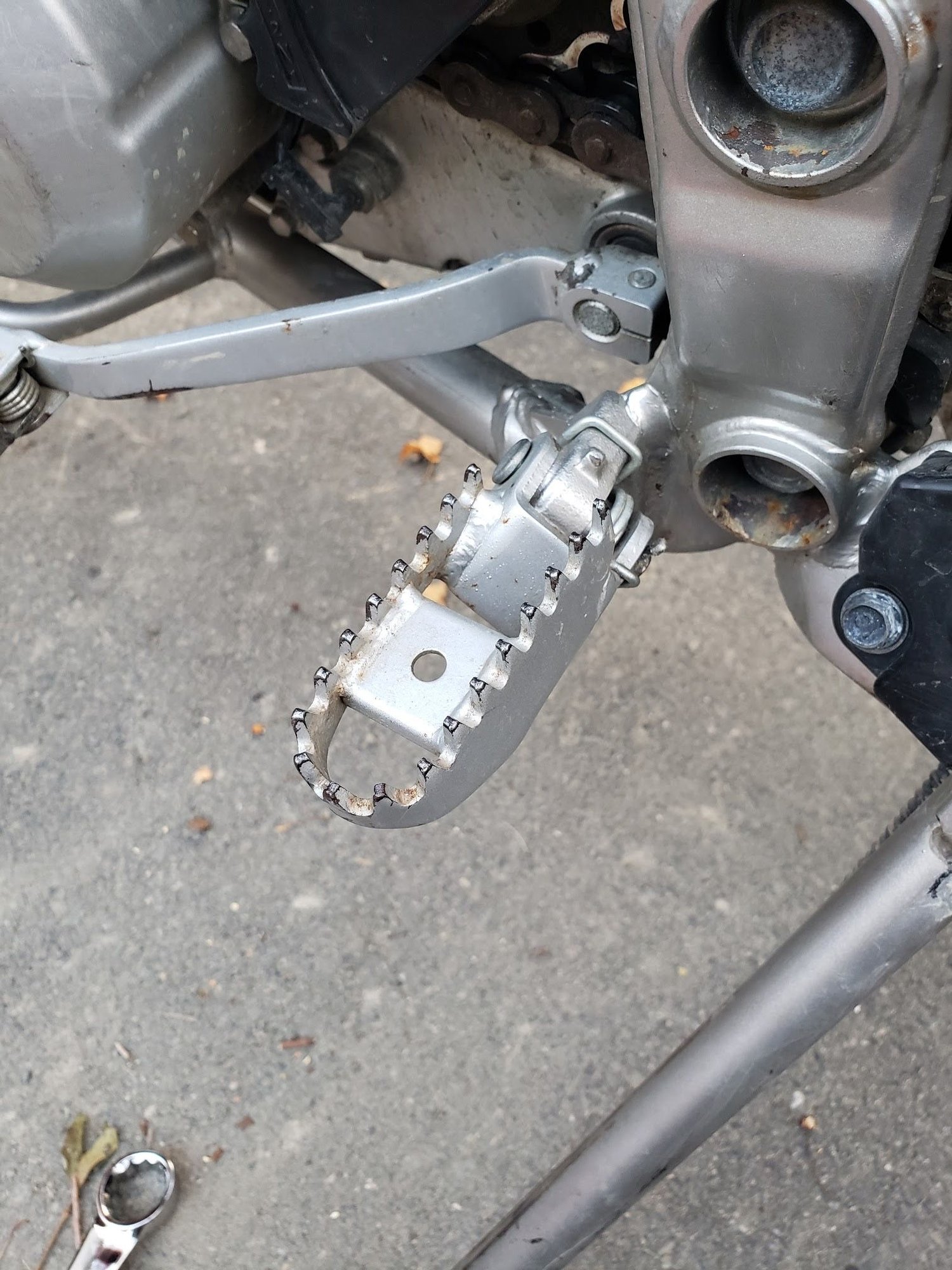

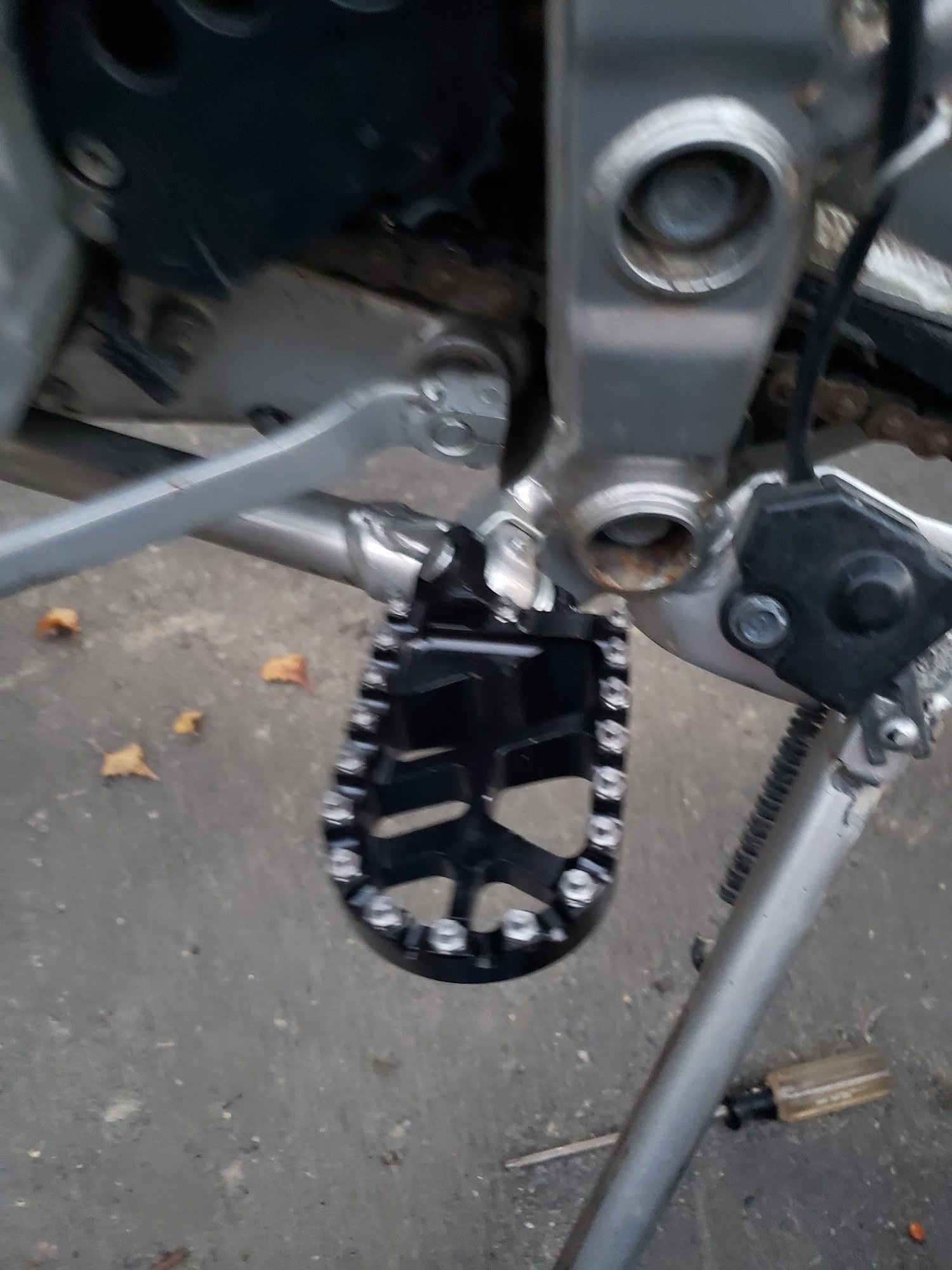

for foot pegs i went the budget route..... but fit nicely.

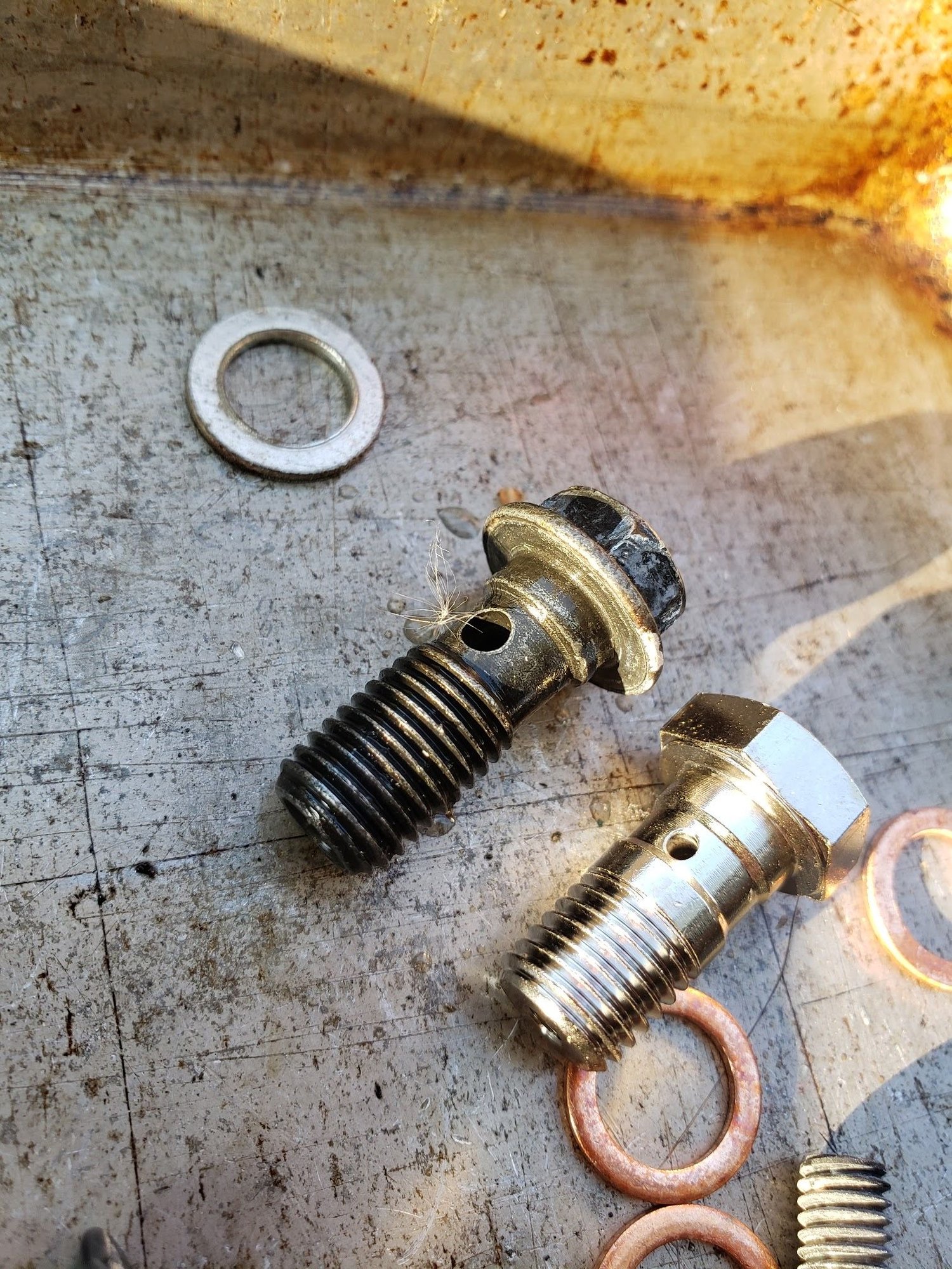

oem banjo bolt vs galfer ..... i reused oem with new copper washers
stock pegs that are too small imho
a budget ebay peg.....fits nicely
the new galfer ss line

Default Amazon foot pegs
Anyone know how to get them to fit straight? Not **** eyed pointing in ransoms forward direction
