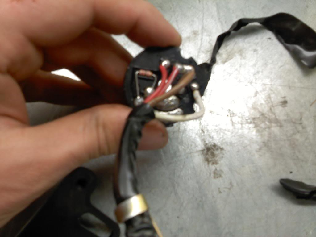

No kidding here.
https://www.kawasakiforums.com/forum...removal-34276/
https://www.kawasakiforums.com/forum...gnition-38139/
See it?

I'm thinking that he changed the key, he did not install the resistor, it is not going to start.
From above link:
Johoff2 9:13 post wiring diagram indicates 6 wires.
Johoff2 9:38 post wiring diagram indicates 2 wires.
IDRIDR post above I can see 4 wires, maybe there are more under his fingers?????
As originally I posted, for 6 wires you should have a 3PDT switch.
On farther review, if you don't have a "park" you could use a 2PDT switch. And, you would only have 4 wires!
You will need a picture that is in focus to identify the resistor specifically, although I believe someone stated it is a 100 ohm.

Yes, it is 100 ohm. The cdi must see 100 ohm between the BK/W wire and ground to produce sparks.

OK GUYS>> I DID THE UNHEARD OF YESTERDAY!! BUDDY AND I PULLED ALL 18 Bikes out of the shop and it got cleaned from one end to the other. Along with new shelves. WAHOOO>> Looked on my KLX250's Shelf and found the baggie of the old fallen apart ignition switch I replaced.. looked like your pic was straight out of my hand because I taped the white rotor to the plate for test runs i.e. always on.. Well Guess what there is the 100Ohm Resister.. So today I am going to get the ol soldering gun out and remove the new switch tear it down and see what its working with and if need be solder the resister in.. Lets pray.. IF THIS IS THE DEAL YOU ALL ARE GODS!!!!!

For the record, I'm positive the switch can be a single throw UNLESS you are trying to keep the security measure. In the "off" position, a parallel circuit is completed so the CDI (as RayCor noted above) sees zero resistance. In the "on" position, the CDI sees 100 ohms. The resister circuit can be wired in so it is not part of the switch and the CDI always sees 100 ohms. That's how my bike is now. This can be done with a DPST switch most definitely, and perhaps even with a SPST switch.
Nathan - I hope you've found the problem! We're pulling for ya. If you cannot remove the resistor, head on down to Radio Shack and pick up a 100 ohm unit. I think mine were two for a buck (for a part that costs a few pennies).
edit. RE: "security" resistor....see how much safer your KLX has been? Security for sure!
