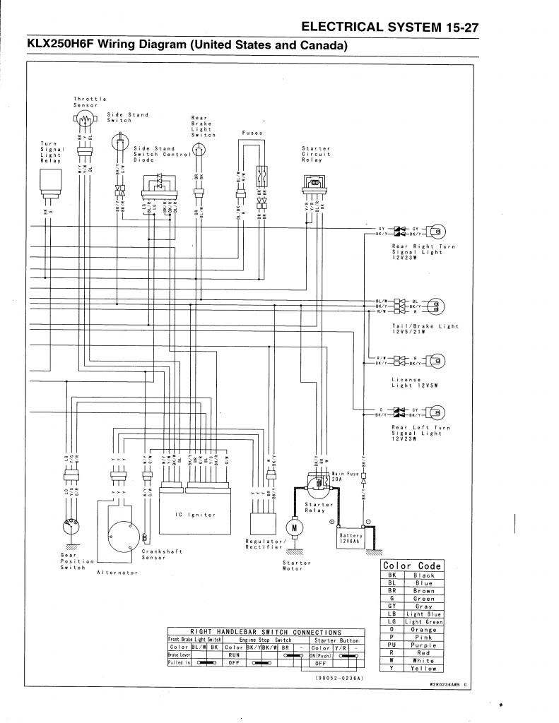

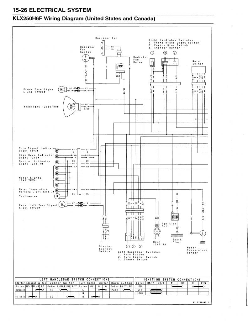

Is there any chance that someone could post up a copy of the OE wiring schematic so that I could see exactly what this 'security resistor' is supposed to be doing? Thanks much.
Please, find it in here and explain it to us. I think I'm blind when it comes to reading these diagrams.
After breaking out my magnifying glass, it seems that the only thing that part of the circuit is connected to the kill switch. Complete the circuit(bk/y-bk/w wires) kills spark but apparently they designed the ignitor to need some type of feedback through that resistor so that it will operate. This is the kind of B/S that some manufacturers incorporate that drive technicians nuts. It's not documented in any of the repair info and it causes many hours(months) of trying to figure out WTF is wrong. If you had not run across this Nate would still be lost(as would most of us). Good catch!

Alright, everyone needs to knock it off. Scott's head is already massive enough that he has trouble find a helmet to fit. Keep it up and he'll just have to wrap it in bubble wrap and duct tape.
Scott, I get the concept of why/how the resistor is working, but I still don't see it in the schematic. Is it a special symbol or something? That said, I wonder if the stolen bike thread currently running where it looks like the thieves were trying to hot wire the bikes but were unsuccessful is due to the resistor?

From: Las Vegas, NV
I only see resistors on the start circuit relay and the fan relay...interesting.
I don't think it is in the schematic. I'm under the impression that these thieves know how to steal something, but they are amateurs when it comes to motorcycles, otherwise they wouldn't be doing this damage in their unsuccessful attempts to start the bikes.
This is also a reason why I and others have been cautious to discuss the resistor. It helped Nathan out. But when thieves find threads like this, will they be more successful? There was one guy over on ADV, new account, low posts, who "just bought a KLR without a key." He wanted to know how to hot wire it. We were reluctant to offer much help.

I think the ignition resistor is "sort of" shown in the '09 wiring diagram by a line bridging the switch BK/W to BK/Y contacts.
You're right. It's not shown at all in the 06 schematic, but *somewhat* shown in the 09.
