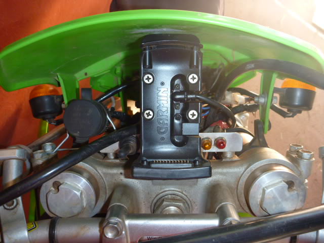

Removed mine ages ago,
You need to drill out the bolts holding the lock to the triple.
There will be enough sticking out to grip using vice grips.
Inside the key switch is a resistor (about 100ohms from memory) and this needs to be wired into the wiring as well as fitting an alternative on/off switch.
I pulled apart the whole assembly and removed the resistor that was inside soldered to the switch contact plate.

I used a single pole switch for the main power, hard wired in the resistor, and didn't connect the park lights.
