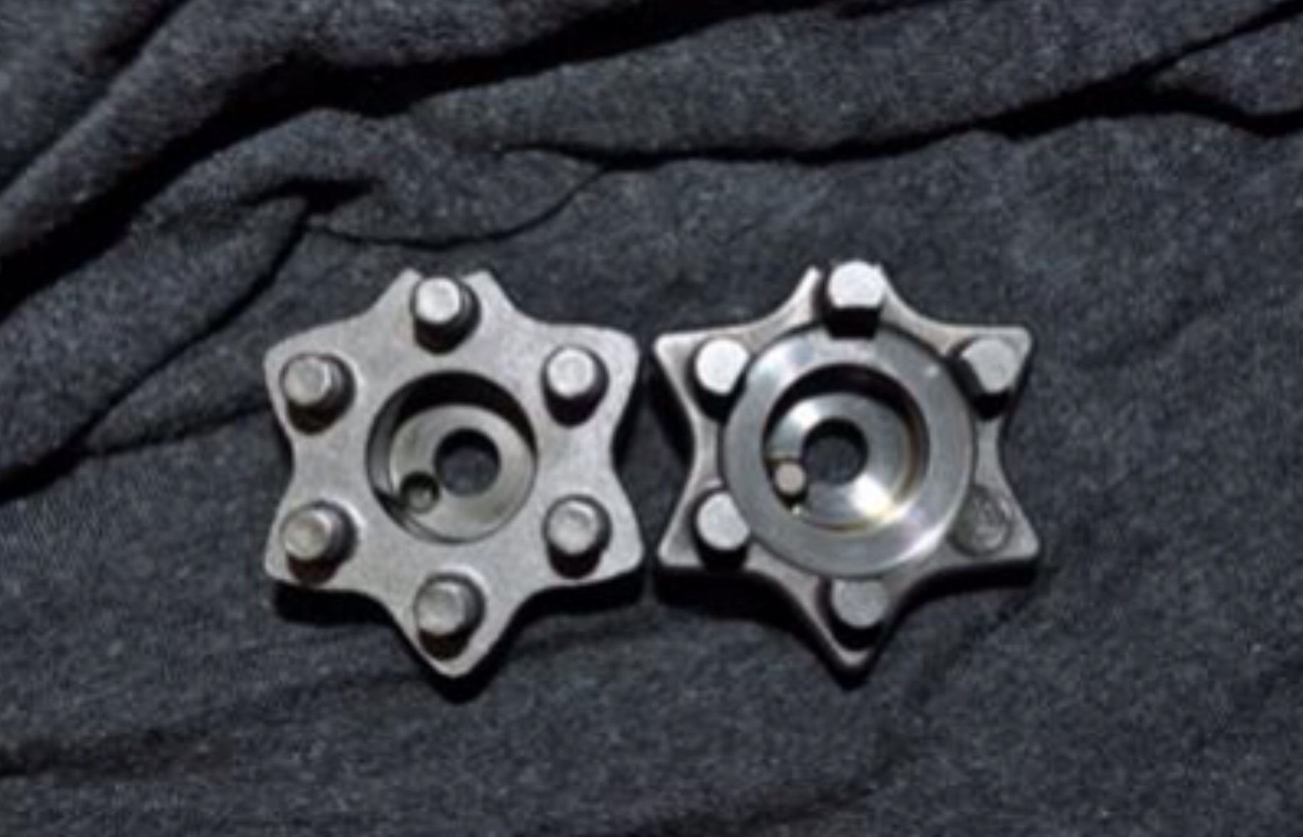

I’m sure jerry will be very interested in your find of the part being incorrect. He was a tremendous help dialing in my keihin fcr carb. I bought the 06-7 star and copied Jerry’s mod using a simple husky die grinder from Home Depot. Seems it did help when searching for neutral when stopped and notchy shifting when the gearbox oil was dirty. That machined in relief on the 09 star makes that cast part a fail safe from major damage to the transmission possibly. Can’t remember why I forgot to get a pic of the star when I was done duhhh
