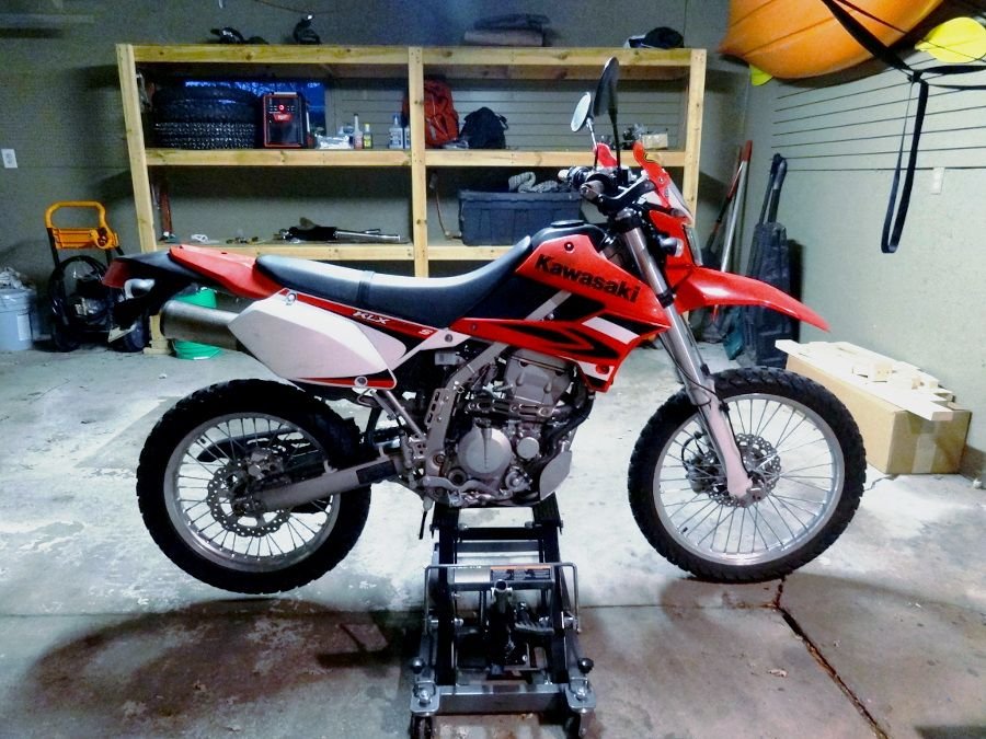

I picked this up at the end of September. It’s a 2009 with 3500 miles. I'm going to add some parts and make some modifications to suit all types of riding. Its going to see street use, trails, single track and sand dunes. First phase is ice bike. I live on a big water system in central-eastern Wisconsin, and we're entering the season for studs!
I'm going to be running with my buddy and his 1979 Yamaha DT175. Its a little 2-stroker enduro, but it cooks pretty good for its size. On an open road my DynoJet Stage 2 KLX and his Boysen Reed DT are neck-and-neck with the KLX pulling away slightly after 65 mph. We're both looking for a little more power, but it will be a good match for the oval and trails.
If I end up going full hog on the KLX and big bore pumper carb, I might even be a good match to my buddies other ice bike, a 1979 Yamaha SR500 flat tracker.
The bike had a few nice mods done already when I got it.
ProTaper ¾ " bars, Cycra handguards, skid plate & a luggage rack that is now removed.
